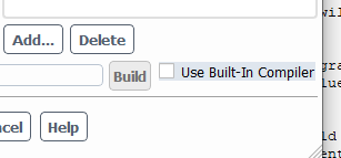

April 11, 2025 at 3:36 pm
Rob
Forum Moderator-
April 11, 2025 at 6:49 pm
wad130
Subscriberthank you! when i tick that i get this error message...Â
""C:\Users\****\OneDrive - University of *****\Disc drive\FYP\Transient CFD\MAYBE_files\dp0\FFF\Fluent\libudf.idl.c" is not found Copy "C:/Users/wad130/OneDrive - University of Birmingham/Disc drive/FYP/libudf.idl.c" to "libudf\src"
ÂÂCopyright 1987-2024 ANSYS, Inc. All Rights Reserved.Compiler and linker: Clang (builtin)Compiler path: "C:\PROGRA~1\ANSYSI~1\v241\fluent"\ntbin\clang\bin\clang-clLinker  path: "C:\PROGRA~1\ANSYSI~1\v241\fluent"\ntbin\clang\bin\lld-linkC sources: []In file included from udf_names.c:3:C:\PROGRA~1\ANSYSI~1\v241\fluent\fluent24.1.0\src\udf\udf.h(81,12): fatal error: 'ud_io1.h' file not found#  include "ud_io1.h"     ^~~~~~~~~~1 error generated.scons: *** [udf_names.obj] Error 1ÂCopyright 1987-2024 ANSYS, Inc. All Rights Reserved.Compiler and linker: Clang (builtin)Compiler path: "C:\PROGRA~1\ANSYSI~1\v241\fluent"\ntbin\clang\bin\clang-clLinker  path: "C:\PROGRA~1\ANSYSI~1\v241\fluent"\ntbin\clang\bin\lld-linkC sources: []In file included from udf_names.c:3:C:\PROGRA~1\ANSYSI~1\v241\fluent\fluent24.1.0\src\udf\udf.h(81,12): fatal error: 'ud_io1.h' file not found#  include "ud_io1.h"     ^~~~~~~~~~1 error generated.scons: *** [udf_names.obj] Error 1ÂDone."Âso because i somehow managed to get it working now i cant anymoreÂ
