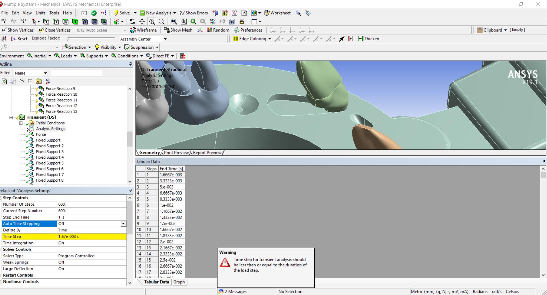

I am doing transient analysis which I want to apply 0.3 N sinusoidal force with frequency of 30 Hz on a part.
But I don't know how to set the step setting like step end time, and also don't understand the difference between defining them by time or substeps.

The rule for Transient Structural time steps is that the maximum time step should put 20 steps in the 30 Hz cycle. That means 600 steps/second or a time step of 0.00167 seconds.

2. When I define the steps and step time I get this error. Honestly I don't understand how these options work? also when the auto time stepping and time integration should be on?

2. In a Transient Structural model, use Number of Steps = 1 and an End Time of 1 second. Then you will get 30 cycles from your load. The time step of 1.67e-3 s will make sure you have 600 solutions over the 1 second, which is adequate to get a smooth response from a 30 Hz forcing frequency.

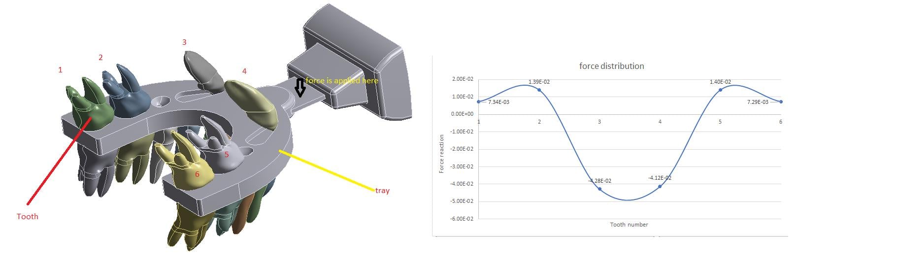

I got confused because I didn't understand what the purpose of having stiffness is. I would appreciate if you take a look at my model attached here and see if the those modal analysis are true. I'm really grateful if you do this favor for me.
Yes both ways give me the same results.
Also if you look at the plot of force reaction for six parts( which are human teeth), you will see some are positive and the rest are negative which I expect only tensile ones not compression because the connection between teeth and tray are not bonded. What would be the reason?

SubscriberThe material specified for the bite plate in your model is crystalline silicon, which is almost as hard as steel. I would have thought a bite plate would have been made of a hard plastic like Acrylic, or maybe a soft material like ethylene vinyl acetate (EVA), which is used for Night Bite Guards to protect teeth from grinding.
For reference, here are the Young's Modulus values of the stiffness of each material including the two in your model.
- Steel  = 200 GPa
- Silicon = 166 GPa this is what you are using for the bite plate
- Tooth  = 20 GPa this is what you are using for the teeth
- Acrylic =Â Â 2.7 GPa
- EVAÂ Â <Â Â 0.1 GPa
Please reply with what you intended to use for the bite plate.
