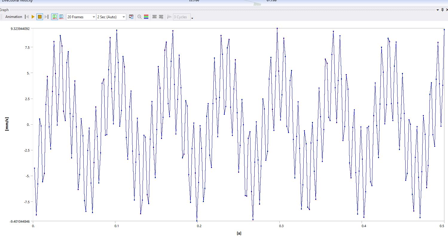

      Currently I am running a model under sinusoidal load and I was interested in geting results when the steady state is archived. Is it possible to set time for ex. after 1s to start calculating results or I need to go through every single time from beginning till the end? In attachment is examplary acceleration to describe the problem.

      So I started the simulation from 9th second to get steady state, but I see distortion in the beginning. Do you know why?
      And changing friction coefficient does not change the system output?

      Could you also explain what is going in first 0.125 sec? Is it structure going from transient state to steady state?
      Also changing friction coefficieint shouldn't change from sine wave into sth. more disorted like in first 0.125s?
      Acceleration.
      Velocity
      Yes, you have a start-up transient that dies out by 0.25 and then you have steady-state periodic motion.
      No, changing friction coefficient isn't automatically going to introduce high frequency oscillations.

      I feel like I messed up something but partial results were promising. Unfortunately solver could not finish calculating. My goal was to represent friction. In real experiment I used vibrometer to capture that phenomena.
      I am still unclear on what you want to demonstrate in simulation.
    • Koperkovy
      I figured it out, I made wrong assumption of point that I am taking results from.
      Thank you once again for your time
