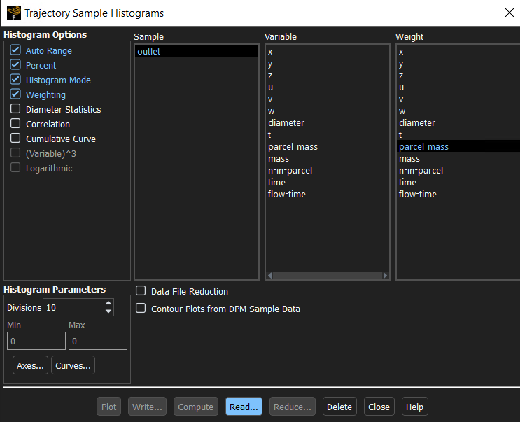

      Where can I find in the fluent manual what these variables stand for?
      Which variables?
    • sjohn
      All the variables in the variable column in the screenshot.
      Most will be in DPM Post Processing, and u, v & w are the x, y & z component velocities. There's some detail in the UDF manual, DEFINE_DPM_OUTPUT, but I wonder if the definitions were deemed "obvious" at some point and missed in an update.
