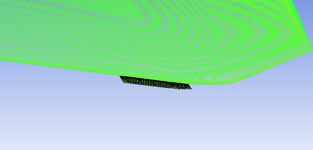

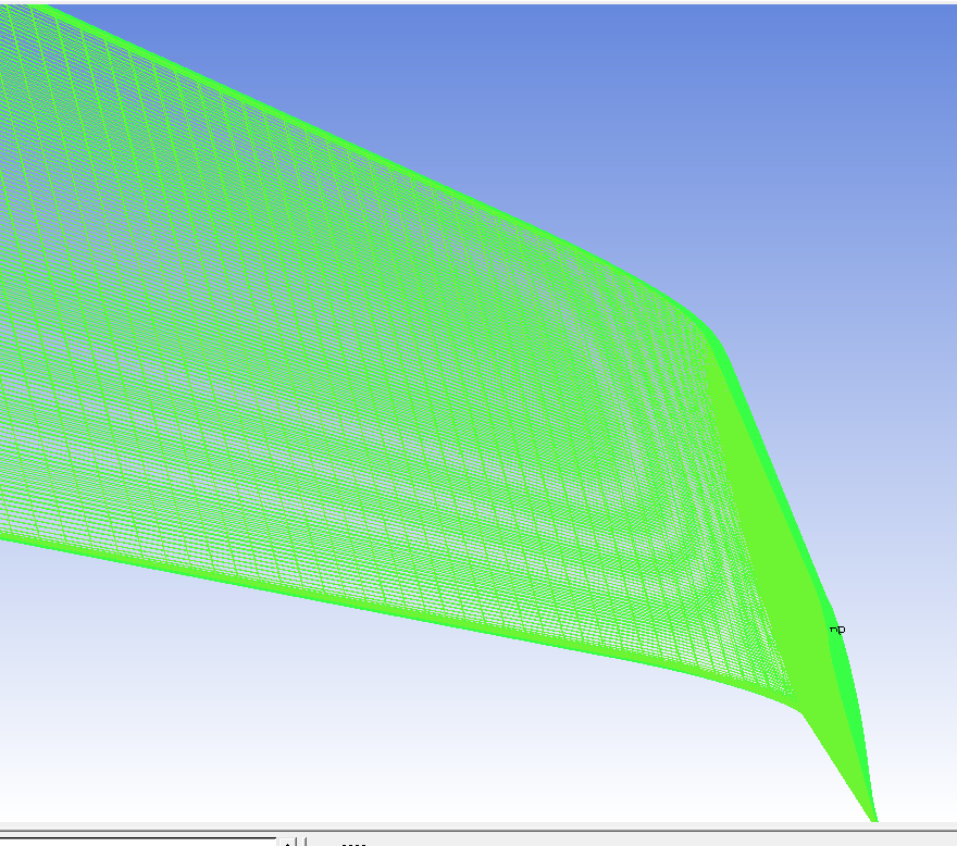

SubscriberHi all, I am meshing a wing using ICEM blocking. The mesh turns out well except at some parts of the trailing edge. See the images. The trailing edge is a separate surface and is blunt. The airfoil is modelled with an O-mesh. The edges between the mid airfoil and TE are assigned. Any ideas?Â
Overview of the wing:

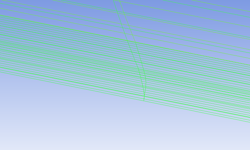

Trailing edge element that works:

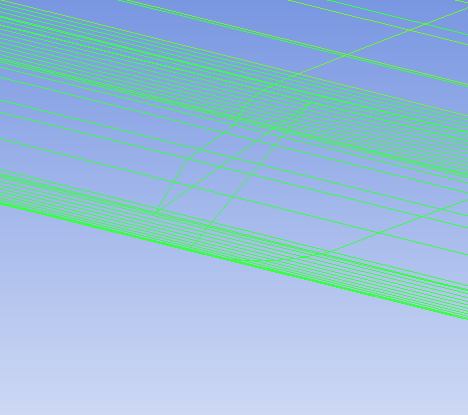

Here it goes wrong:
Wrong elements:

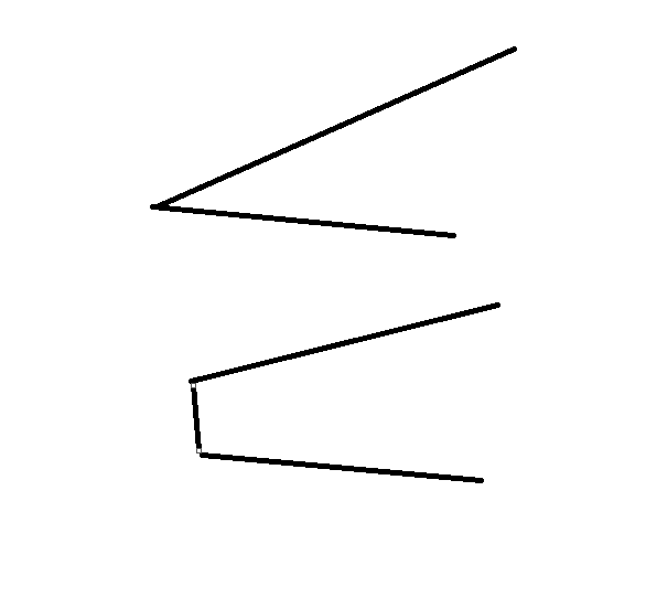

Ansys EmployeeIt is not very clear from images. You may want to slice wing surface and blocking more and give more edge association. You may also try chaning geometry at trailing edge as follows.Â
Please go through help manual for more detailsÂ
