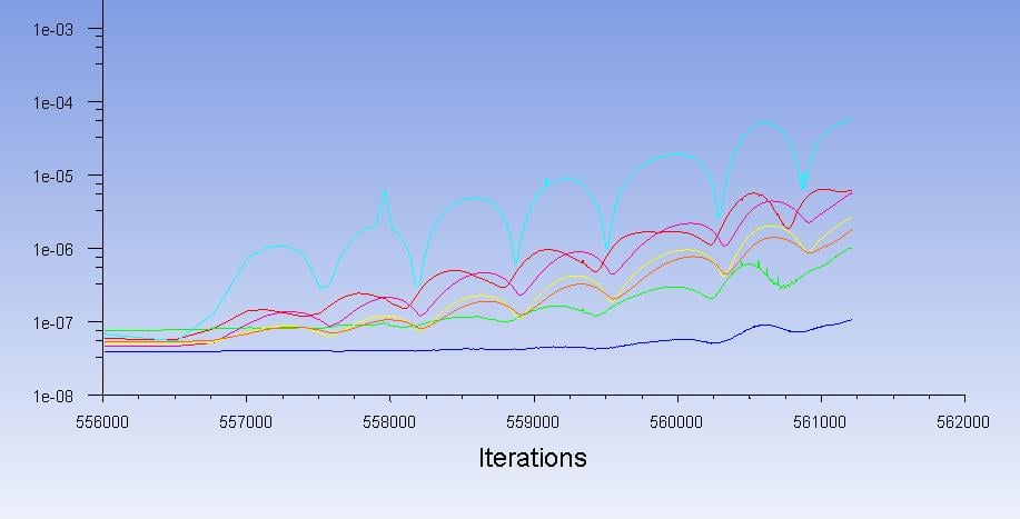

I am doing a propane combustion simulation with fluent. Actually I am trying to reproduce literature results. My maximum temperature is 100K lower than literature results.Â
I am wondering is this because my case is not converged yet. all the residuals in my case are flat. The monitor variable kept constant as well. Then I checked mass balance of the combustor, it's balanced. Finally I checked the total sensible heat transfer rate. The detailed data set is as follows:
inlet: -58.4W
outlet:-200W
external_wall:-182W
heat of reaction source:461.55 W
net:9.74 W
I know that the net heat transfer rate of the whole system should be 0 if the case is fully converged. However, I can not make it smaller with further iteration.
I am wondering is this an acceptable value to determine convergence or are there any ways to decrease this value further in order to get converged case.

I can not reduce the residuals by further iterations under the current energy under relaxation factor which is 0.9
If I increase the under relaxation factor of energy to 0.95, the whole system would become unsteady. The maximum temperature just vibrated between 1600K and 2100K back and forth in just tens of iterations.
However, when it vibrated to 2100K which is very close to literature results, the total sensilble heat flux would be very close to zero, which indicates convergence I think.Â
I am wondering how can I make this system steady and approach to converged results without oscillation.Â

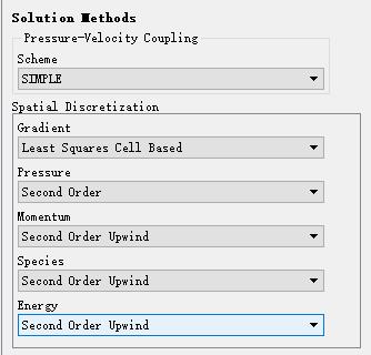

SubscriberHi,
I think I just followed the solution method settings in the paper. Velocity and pressure is coupled with SIMPLE. All terms are discretized with second upwind method.
I don't have access to my computer now. I will confirm the solution method further.
