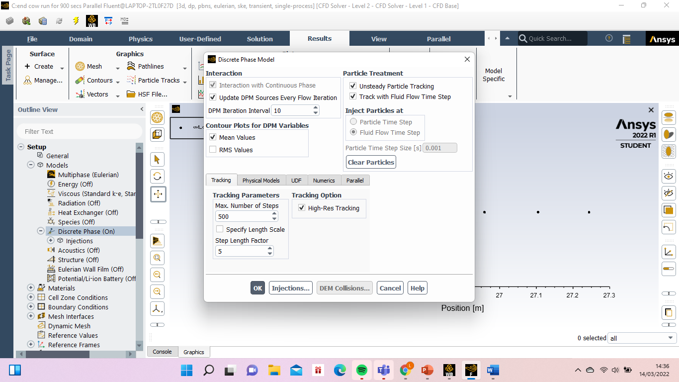

 Particle time step is something you set, in the above it's the same as the flow time step. If you're running a steady flow you can use transient particles so there's a particle time step to consider.
 March 14, 2022 at 5:00 pmLylad SubscriberHi rob thank you so much for your reply, if I wanted to calculate the flow rate would I use the formula above ?
 And does that mean that the particle time step is equal to the flow time step that you specify in the run calculation page?

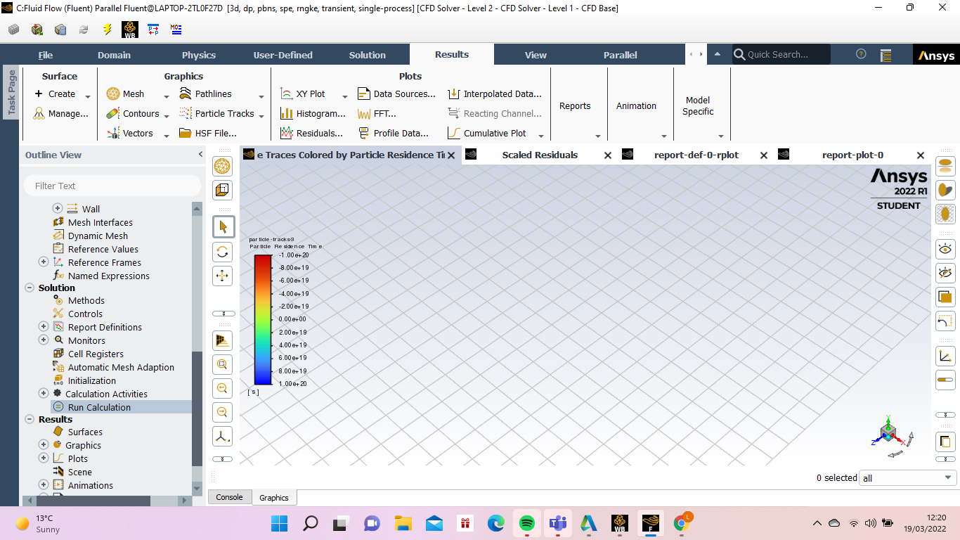

 Also I have another question i've been using the droplet function for the particle type however it only seems to show the particle results when the simulation is in steady state.
 But I want to run the simulation in transient is there something else I need to enable or another reason for this ?

 March 19, 2022 at 12:23 pmLylad SubscriberHi just to confirm these are the boundaries I am using but its not showing any particle tracks in results
 Transient: on, gravity y=-9.81
 Models- Energy= on, Species transport= on, viscous= k-epsilon/ RNG/Standard Wall functions
 Discrete Phase= ON, interaction with continuous phase , unsteady particle tracking, track with fluid flow time step.

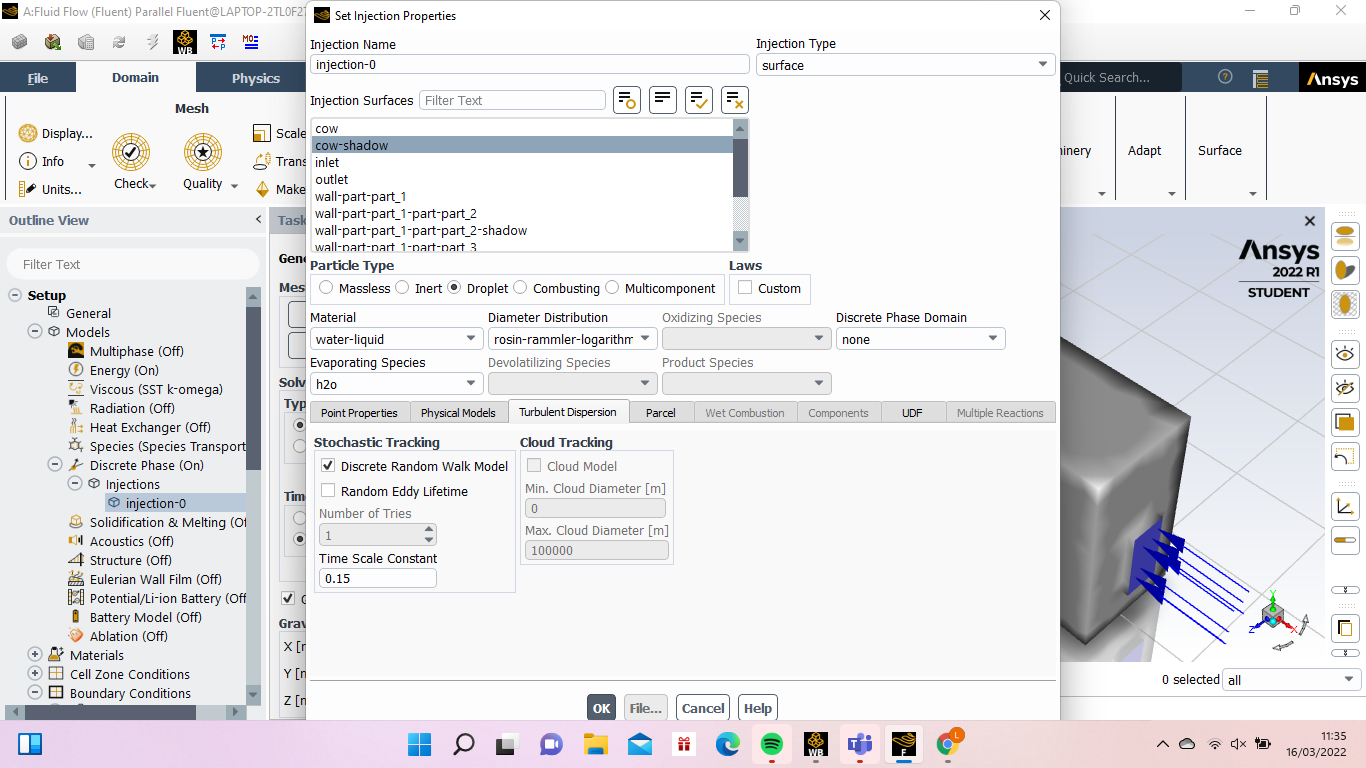

 Injection= surface, particle type= droplet, material= water liquid, evaporating species= H20, diameter distribution= rosin- rammler.
 injection velocity= 10 m/s, temp= 300 K, start time =0 stop time= 10 secs, flow rate= 1e-20, mean diameter= 1e-5, ticked scale flow rate by face area
 Then for boundary conditions= inlet= 8.7 m/s and outlet= gauge pressure is 0 (nothing changed for the outlet values)
 Hybrid initialization
 Run calculation; number of time steps= 1000, time step size= 0.1, max iterations= 20
 Bellow I have put a picture of what results it produces when I try to run droplet particles I'm not sure why it's not showing proper particle tracks I would appreciate any help as I want to model droplet infectious aerosol with a transient model.

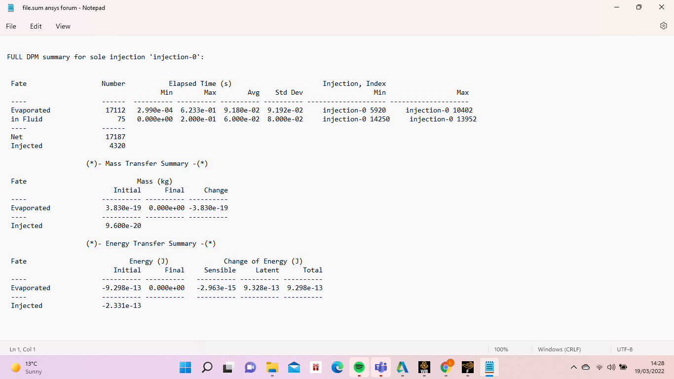

 March 19, 2022 at 1:29 pmAmine Ben Hadj Ali Ansys EmployeeIf you display the particle summary what do you see in the console?
 March 19, 2022 at 2:29 pmMarch 19, 2022 at 3:55 pmAmine Ben Hadj Ali Ansys EmployeeAlmost all particles have evaporated. So no particles traces can be displayed as they are not there. The other remaining particles are still in domain and you should be able to see them. You scale up the size of displayed particles.
 March 19, 2022 at 8:09 pmLylad SubscriberThank you so much DrAmie I've increased the size of the particles and I think thats worked :)
