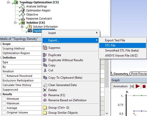

I am a new user of the topology optimization toolbox in Ansys. I was trying to get the topology optimized part back in spaceclaim. (I already optimized the part and I was trying to use the reshape the optimized part in spaceclaim but I keep getting an error which says
"Update failed for Geometry component in Model,static, structural . Update of the geometry component in Model, static, structural did not mark the component as updated due to a change made to the Results component during the update".
I am using the latest version of ansys. (19.1 Student version). I would really appreciate if anyone could help me with this problem. I have attached here a screenshot of the problem.

Ansys Employee@Diptanshu
You would need to follow these steps:
@Peter
 By default the Topology Density will be exported as an STL. However, if there are more result objects in the tree (which doesn't seem to be the case here) it is possible that the defaults might change:
 Please check the following in the Solution settings:
Also, note that you can right-click on the result and just export it to STL:
Now, the reason you didn't see the optimized geometry is that after you right-click on C3 and click on Refresh. When you open the geometry in SpaceClaim, here you would notice that by default the optimized part is suppressed. You would need to Activate for Physics:
The intention is to un-suppress the optimized part, clean it up using SpaceClaim tools, convert it to a solid. Full CAD conversion can take some smoothing operation etc with the tools in Facets tab and then fitting geometric features to it. However, for a quick validation run. You can do this as shown:
Hope this clears it?

SubscriberHi everyone,
Thanks for finding time to put in your inputs. I was able to export the optimized geometry by 'exporting as .stl' file. (The update thing on the geometry on the C block still didn't) work for me for some reason) Though I might have to try it again. I was able to clean the geometry and run simulation on it again. I would appreciate any comments on the same. I have attached here the pictures for your reference.
