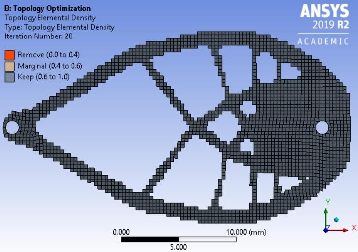

I would like to draw a graph similar to this one. -

SubscriberYou can do a Topology Optimization to create structures like the one you show in the image.
You start with a definition of there you have to hold the part and load the part, and the available space for the part. Then the Topology Optimization will solve for where the material has to remain to support the load.

SubscriberMy question is about the graph above. I have done a Topology Optimization analysis and now, i would like to draw a graph similar to the one above. The classic graph returned by the process is not that smooth and it's not symmetric which seems to be a bit strange.
I guess I need to add a user defined result like the one I'm using (=TOPO) to get the density map but I didn't find any information about that on the Internet.

SubscriberThe difference between your result and the image at the top of the discussion is mesh shape and size. Mesh with quad (2D or hex in 3D) elements and use a smaller element size and you will get a solution that is smoother and more symmetric.

And do you know if it is possible to draw a graph showing only elements with a density equal to 1 for example ?Â

Plotting elements with a density equal to 1 is not useful.
You want to plot elements that have a density greater than 0.6 or 0.8 or any other number.
If you plot Topology Density, you get to choose that value based on Nodal Results and that results in a smooth outline.
If you plot Topology Elemental Density, you get to choose that value based on Element Results and that results in complete element outline.

Last question : what did you do to get your second graph, this is exactly what i want ? Is it a user defined result ?

SubscriberThis is one of the standard available results, and is also available as a User Defined Result ETOPO
