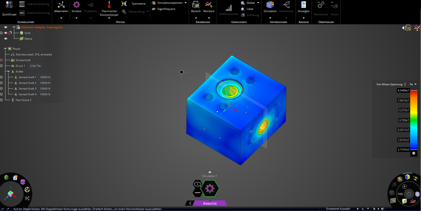

      I am currently testing Ansys Discovery and would like to do a topology optimization. Unfortunately I can`t enter the topology optimization since there is no button available. Is this application not included in the trial or did I miss something?

      Topology optimization is available only in the Explore mode for structural simulations.
      Please switch to Explore mode to view the Topology Optimization option.

      Hello Subashni, thanks for your help. But how do I enter the explore mode?
    • lukas.jebinger
      Problem solved: Graphics card driver was not up to date.
      Discovery requires CUDA version 11.0 or later. Please try updating graphics driver.
