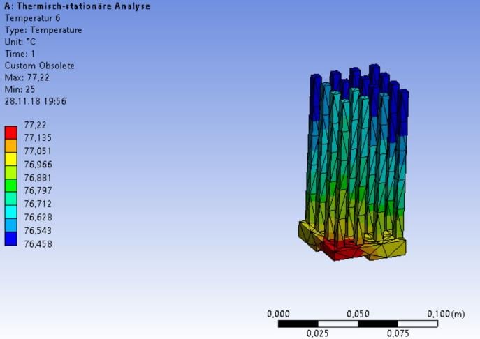

      You are describing a heat sink, and fins are the conventional solution to this problem. I recommend you add two new features to your model, saw cuts along the length direction and saw cuts along the width direction (assuming the depth direction has the heat flux on the bottom face).
      You can have three parameters in each direction for the number of cuts, the saw cut width and the saw cut depth. The saw cut depth should be a percentage of the part depth and not exceed 90% or some other constraint. The saw cut width will have constraints such as the minimum cut width, while the maximum cut width will depend on the number of cuts and the part length (or width for the other parameter).
      If you assume symmetry, you can reduce the size of your model to a 1/4 model.  Here is an image from a recent post.
      You will be doing Shape Optimization, not Topology Optimization because the topology is fixed by the parameters, though the number of cuts does change the topology, but in a very specific way, not organically like the Topology Optimizer would.
