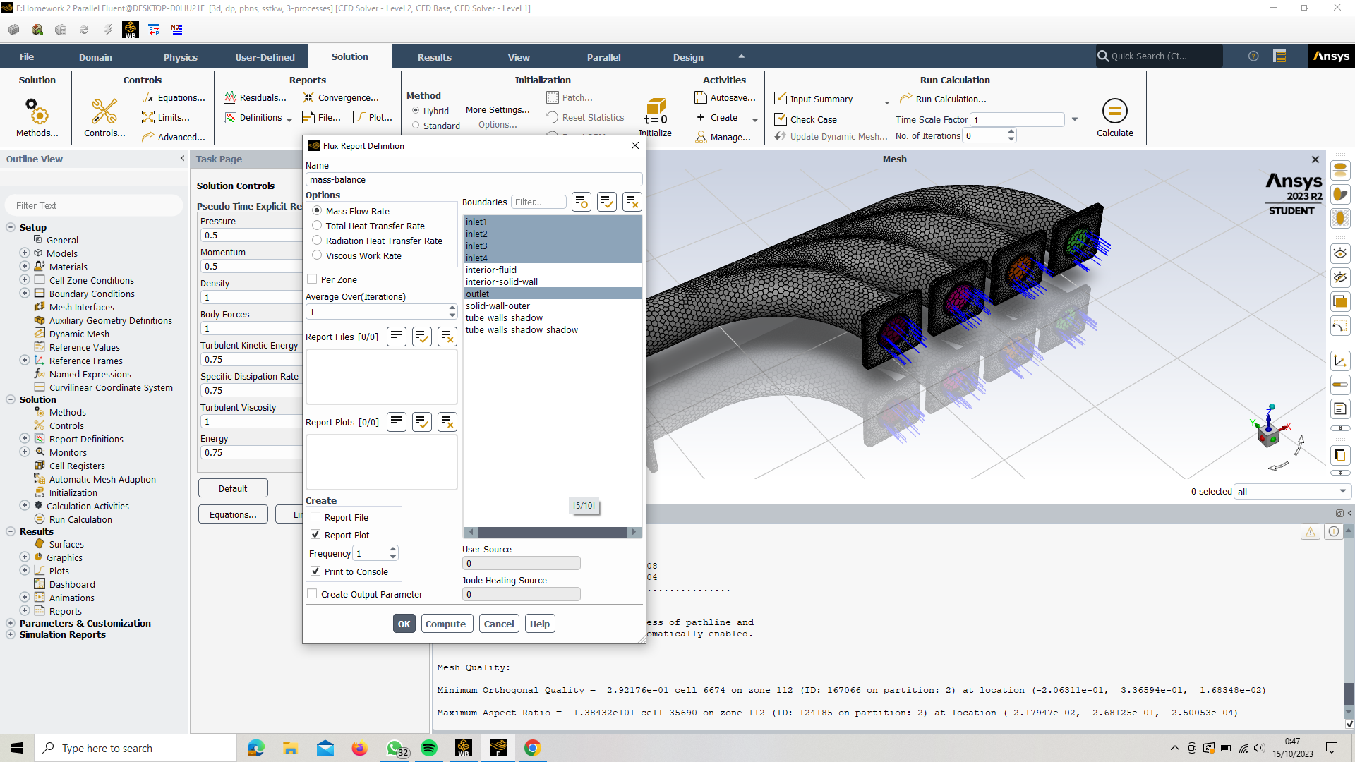

      Good afternoon colleagues, I'm Erwin, permission to ask, in Course 4 - Homework - Flow Through an Exhaust Manifold Fluent Matery on the Flux Report, what is the function of the Report Plot and Report File? Thanks
    • dzikrian.d
      Hello, Erwin,
      The report plot will display the report definition plot during calculation by the solver. Meanwhile, the report file will write the report definition in a single file
