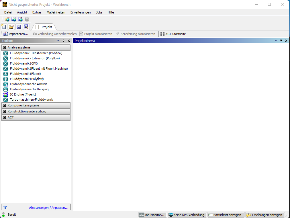

i installed 2021R2 multiple times however the toolbox only ever shows the systems in the toolbox as shown in the pic.
Tried resetting the layout and views to no avail. Im running Win 11 .

December 3, 2021 at 1:24 pmRob
Forum ModeratorWe don't officially support Win11 at present, so it's possible it's a problem with the operating system. Download & extract the folder again & see if it's an installation problem.

December 7, 2021 at 1:33 amkipoon
SubscriberHello Saad21011996
I had the same issue as you (only CDF apps were shown in the Workbench) and I managed to solve the problem. Try running Fluent from the workbench. If you get a license error -88309 then we have the same issue. I am also running windows 11.
