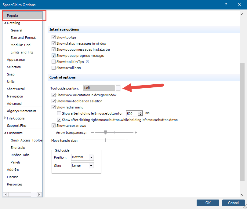

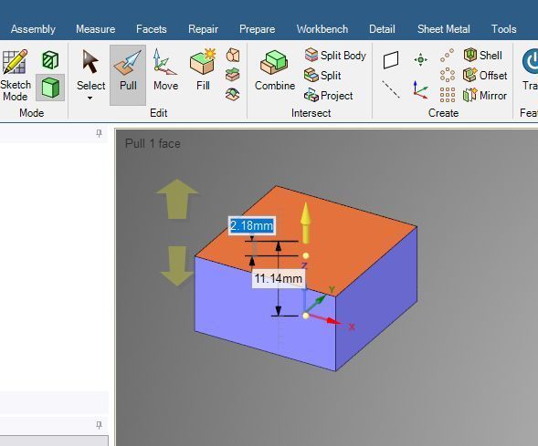

On the other hand: why is it make sense not to show the tool guides? If the tool guides are not shown how to reach the specific functionalities related to a task?
Csaba
June 11, 2019 at 3:19 pm
Brian Bueno
Ansys EmployeesteelxpertÂ
This is usually caused by a conflict in the options between Discovery Live and Discovery SpaceClaim. I believe I may have had the same problem at the time I installed 2019 R2.
