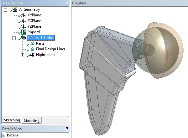

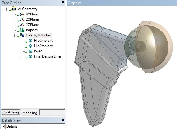

      I used ANSYS 19.2, opened DesignModeler and used File > Import External Geometry File and pointed to Assembly.x_t
      I see four solid bodies.
      The Hip Implant is in two parts. Use Form New Part to put them into a single part. That will allow the mesh to connect the two bodies using a common set of nodes.  You could do the same with Part2 if you want.

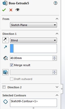

      If I open Hip Stem in SW (SLDPRT) I see there is one feature that you forgot to check Merge result so you ended up with two bodies.
