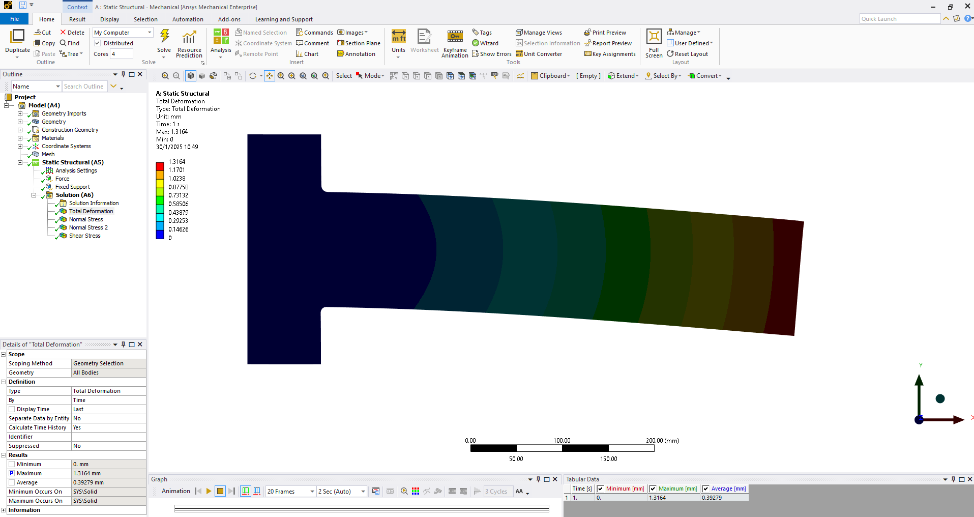

Please check the Lighting Properties under Model Details and set Ambient, Diffuse and Specular values correctly.
It is possible that Diffuse values were disturbed(reduced to near 0 value) leading to a dark image. Try to increase this value to around 0.5 or higher
Check Ansys help to better understand each settings Model
January 31, 2025 at 7:26 am
jordi.marce.nogue
SubscriberThanks! That’s the solution!
I really didn’t know about this option, and I kept trying 'Options' and 'Preferences' in the main menus without success
