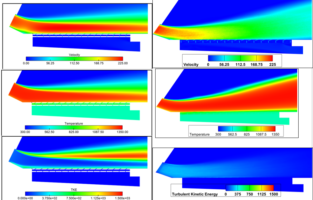

TKE underprediction in shear layer
TAGGED: , ,
    • pablobhs

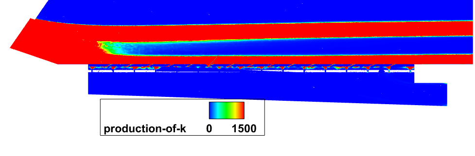

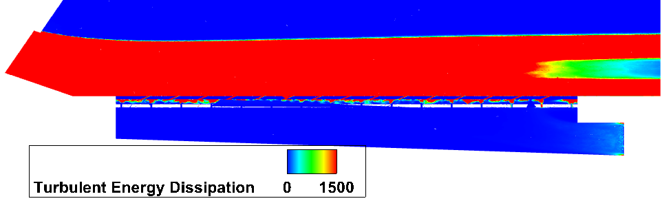

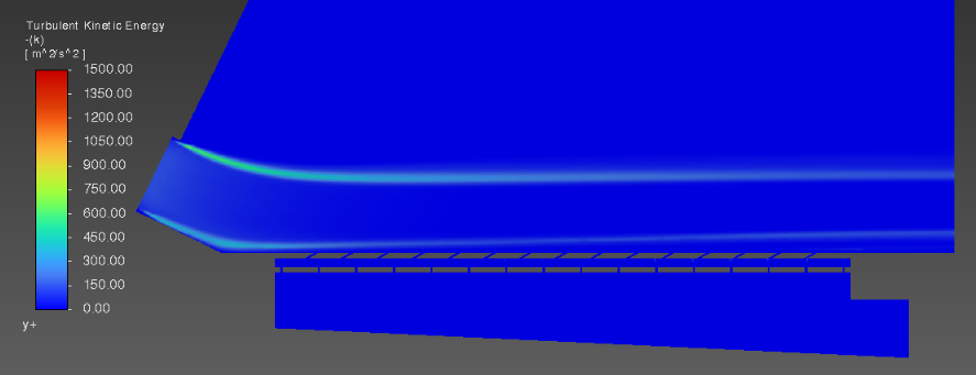

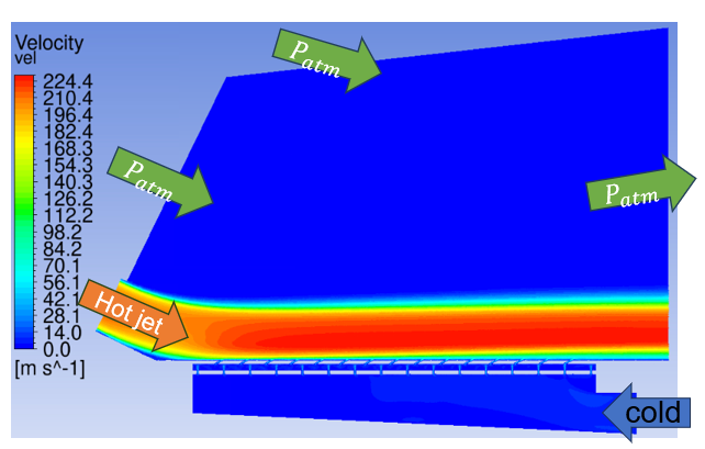

      I am trying to model a hot jet impinging at an angle on an effusion cooling plate. While comparing my simulation with a colleague's results, I saw severe underprediction of TKE generation in my shear regions. I plotted production of k which seems to be fine, however the dissipation is probably too high. Is the fix more mesh-related or a turbulence model issue? Im using k-omega sst with default settings except production limiter is turned off and viscous heating and corner flow correction are turned on.

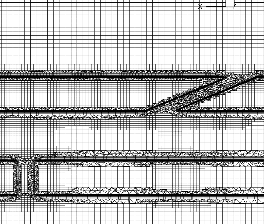

      Mesh is a bit slender at inflation layers. This can create the cell jump issues. Can you try using polyhedra mesh?

      The issue may be related to sudden cell jumps in shear region. Since the velocity is quite high, these cell jumps can be detrimental to the solution.
      Is the cross-section a square or a circular? Two-equation models are known to overpredict dissipation, which can result in lower TKE. Please use higher order discretization schemes. Ensure the y+ values are adequate.

        The cross section is essentially a "sliver" of two rows of cooling holes, 2.18mm wide.
        y+ is <0.3 throughout the domain, except on the free slip "side walls" where its 0.5.
        I tried running a transition SST with QUICK discretization schemes for everything. No noticable changes.

          I see. Thanks for the information. What about the mesh? For the given velocity field, the mesh seems a bit coarse. Can you try to run the case once using Reynolds Stress Model (RSM)? This will help us to narrow down the issue.
        • pablobhs

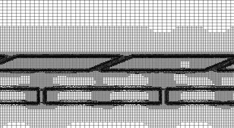

          Here's how the global mesh looks. Max. cell length is 3e-4m.

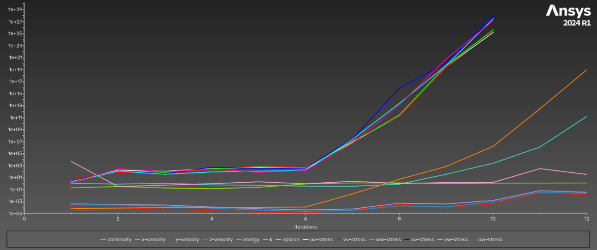

          Ran the RSM model. It gave a floating point exception with QUICK schemes and diverged with 1st order upwind schemes.
    • skulkarn
      Run the case initially with two-equation models and then switch to RSM. I don't see inflation layers at the wall in some places. Please avoid using cut-cell mesh to avoid sudden cell jump.
