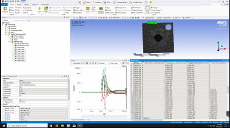

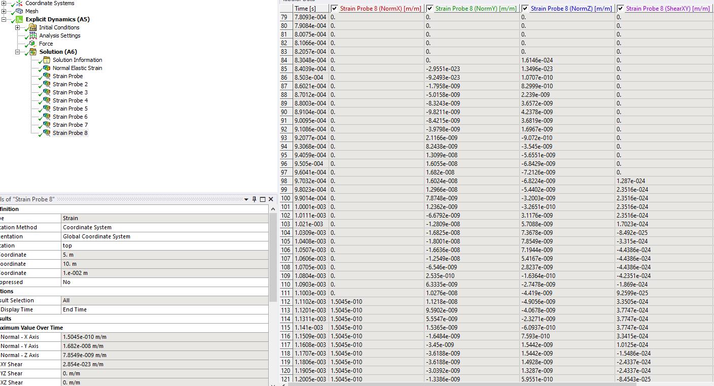

I am trying to simulate strain gauge data for a wave propagating through variations of plate geometries in Explicit Dynamics. I have distance between the impact and a single hole parameterized with DesignModeler with the idea that I should be able to vary the distance and evaluate the experiment at each distance.
When I try to parameterize a full strain result, all I see are options for maximum, minimum, and average, which are undesirable as they apply to the whole body, and would not seem to allow one to get data for a specific point. Using a strain probe, I checked the parameter box for equivalent strain under results.
When this comes over to design of experiments, the parameter returns a single floating point number. The data I would like to see is a time series of strain at 200 times through the experiment. I found a workaround by parameterizing display time of the probe and manually entering time steps to appropriate resolution, but judging by run time it runs a fresh simulation for each individual design point, and where I look for about 200 time steps, evaluation time for a single experiment has now gone up 200 fold, which will not scale well for further models, especially when catching unexpected failure in a reasonable time.
Is there a more elegant way to extract some time series data from a parametric analysis without initializing a new model for every step?

   Thanks for the fast response. Although we are using DOE, our goal is not to optimize any design. We plan on monitoring multiple sites, and collecting relevant data - strain, deformation, and stress. We plan on using this time-series data in deep learning.
   To give better insight, the first image shows how we seek to collect 200 time steps of data from a single variation of the geometry.(as shown in the "Modeling" window of Workbench)

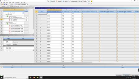

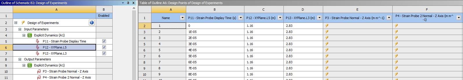

   The second image shows how we attempted this, using DOE design points + parameters. This method is not realistic, as we are solving the same system 200 times for 200 data points. Ideally we solve it once for every 200 points, just as you can within "Model" of Explicit Dynamics.
The issue we are running into is that we are solving for a new system for every design point, and it is taking far too long to collect the data we need from a parametric study. Our question is if there is whether we have overlooked some functionality of Workbench, or if there is a better way to go about this process entirely?

SubscriberThe way to not have the system solve 200 times for 200 time steps is to not put the time step as an input parameter.
Instead use 200 output parameters, one each for a specific time, then it will solve once and give 200 outputs for one station.
I understand this creates 200 columns and you want 200 rows, but that is not how the Parameter Set table works.
Another approach is to have the solver write an output file with the data from each time step in its own row in the file.
