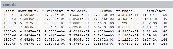

      i'm running a simulation where after a while I got an time/iteration of more than 1 hour. does anyone now what the reason could be?
      I'm running only single precision. I tried to run parallel, but then my dynamic mesh doesn't work anymore.

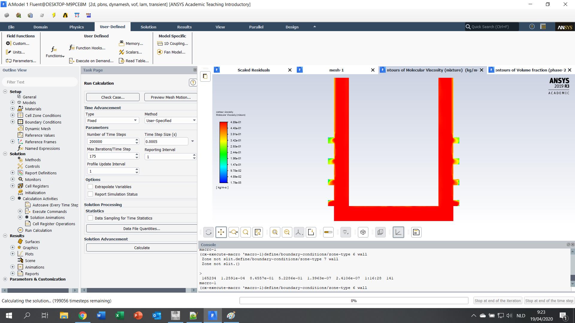

      Do run double precision. The message it too small but it seems you are executing a macro which transforms an interior to wall and back I guess. Probably here an  issue is occurring. Are you using dynamic mesh events? Can you try that without any events:, just try changing boundaries back and forth for testing.

      I change my two pressure outlets to walls, but even if i don't do this I have the same problem.
      Yes i'm using a dynamic mesh, where the inner horizontal line, goes deeper until a certain end point.

      Can you figure out why the macro it is executed? Is it your macro?
      Regarding double precision: You need always to run in double precision.

      yes, the macro is to switch the boundarys to walls. I wrote this myself.

      Does it work without your macro? What does the macro do?
    • bobd
      Yes it works without the macro but I keep having the time/iteration probems.
      Here is my macro code:
      (cond
      ((> (rpgetvar 'time-step) 930)
      (ti-menu-load-string "define/boundary-conditions/zone-type 6 wall")
      (ti-menu-load-string "define/boundary-conditions/zone-type 7 wall")
    • DrAmine

      Well that in the beginning of my simulation the time/iter ationequals about 0:00:05. but now it is equal the numbers down here which is really long if this is only one iteration and i have 150 iteration per time step.
      So, the simulations goes really slow
    • DrAmine
      You can ignore that: do not focus on that number. Better is to benchmark your case and run say 100 time steps and then check the timer usage. Disable all I/O and run it in batch for accurate performance tracking.
