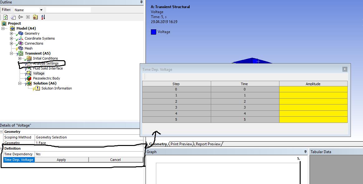

      I am doing 2-way transient FSI in ANSYS 19.0 Workbench with Transient structural solver, Fluent and system coupling using a piezoelectrically actuated micropump. I have enabled the ACT piezoelectric and MEMS extension for the piezoelectric actuation.

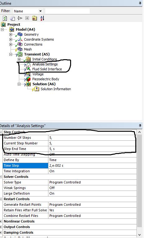

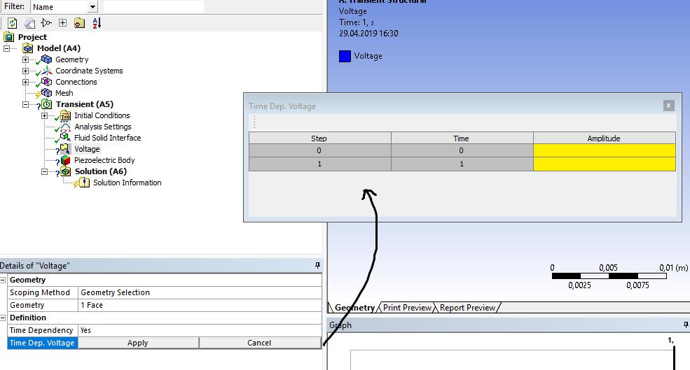

      In transient structural, when setting the actuation voltage with time dependence selected to "YES", a table pops up. The no. of rows in the table is dependant on the no of time steps mentioned in the analysis settings. No of rows in a voltage table cannot be manipulated manually by a user indeed it is automatically manipulated by the Analysis settings.
      For a 2 way FSI to be performed in ANSYS using system coupling we cannot define no of time steps to be not more than 1. So this means voltage can only be defined for 1 time step.
      In my case I have to study the influence of driving load applied to the piezoelectrical actuator (Time varying Sinusoidal voltage with a certain frequency) which is mounted onto the micro pump chamber on the flow rate of micropump.
      So, I am not sure as what to do for this kind of a problem. Kindly, let me know the solution to this problem.
      I am attaching few pictures for better understanding of what I said above.

      I did trying that but it did not work for a 2 way FSI. Since even if we define no of steps and time via apdl commands for voltage in Transient structural solver, we are suppose to enter those same time steps in Analysis settings and the problem is same as mentioned above again. ANSYS allows only 1 time step in its solver.
      Is there any other way or am I missing out some logic while writing apdl commands because I have least knowledge of commands.But I tried implementing them.
