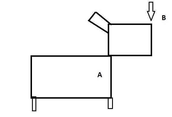

      The attached image shows the shape of the machine. Point A shows centre of gravity. Load of 150kg is to be applied at Point B. Is it possible to simulate in Ansys that if the load is applied will the machine tilt towards right side or not?
      Actually, I tried to do in static structural but it shows deformation at point B area (as expected)
      I am really sorry for the poor image i draw to explain what i meant.

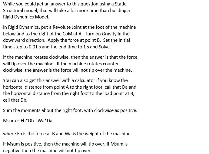

      If this answers your question, please click Is Solution below, or ask a follow-up question.
    • usama4rehman
      Thank you very much for your reply. Yeah with calculator its much easier the answer came out to be 140kg thats why I asked to simulate it for the 150kg load (+10 kg for safety). I will try doing it in Ansys now.
