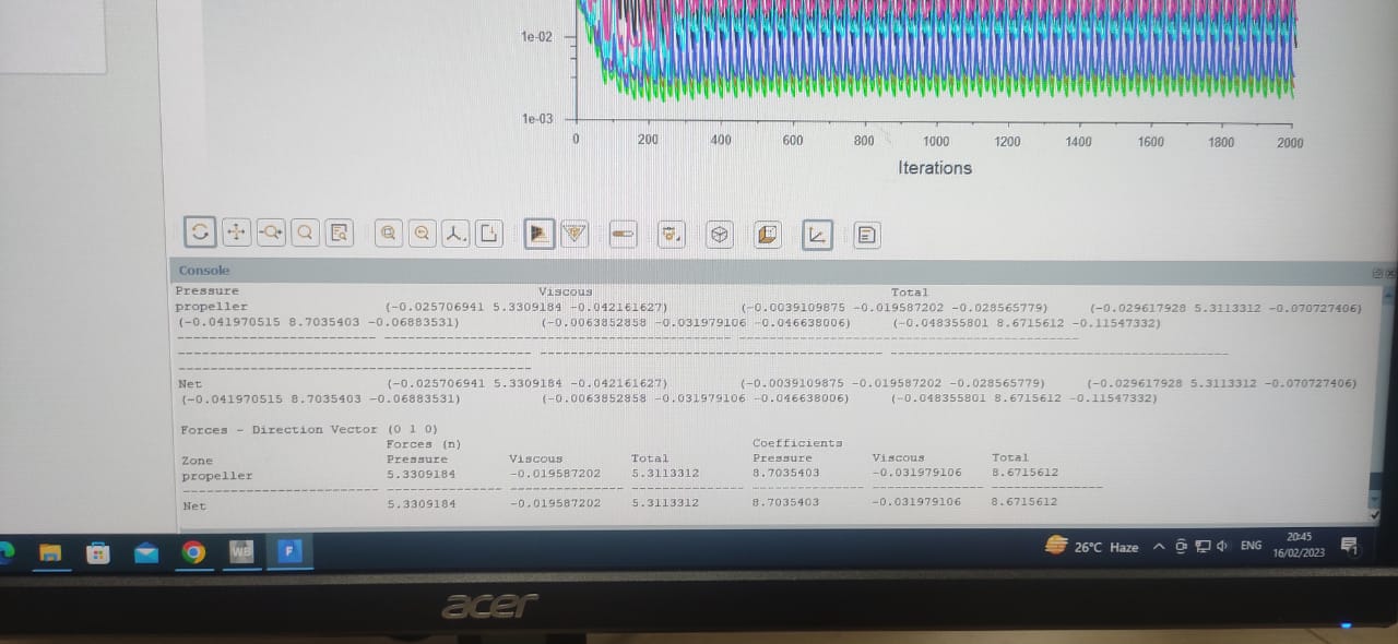

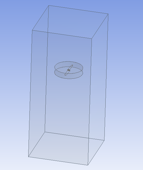

SubscriberI need to find the thrust generated by the propeller of the drone so I did the analysis on ansys by generating rotary domain and static domain. But I am unable to read the result i.e when I click reports >> forces >> propeller >> print , It generates some of the values under the heading pressure,viscous and total .So out of the given values which is my thrust value and in what unit . I herewith attach my model and result for your ready reference. Please help me out.Â
if possible please share the valid proof because after this analysis I have to fabricate it also.

Ansys EmployeeHi,
Total represents the thrust force. Unit here is Newton.
