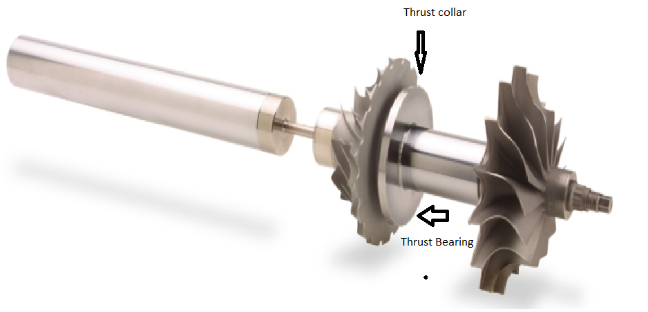

      Hi, can someone help me with how to implement a thrust bearing in AnsysWB on the rotating shaft if the stiffness and damping values are available? To perform the modal analysis.

      Could you please give me an example of where this Combi214 was used as a thrust/axial bearing? Because I’m assuming that it can only be used as a radial bearing.
    • Cheta Rathod

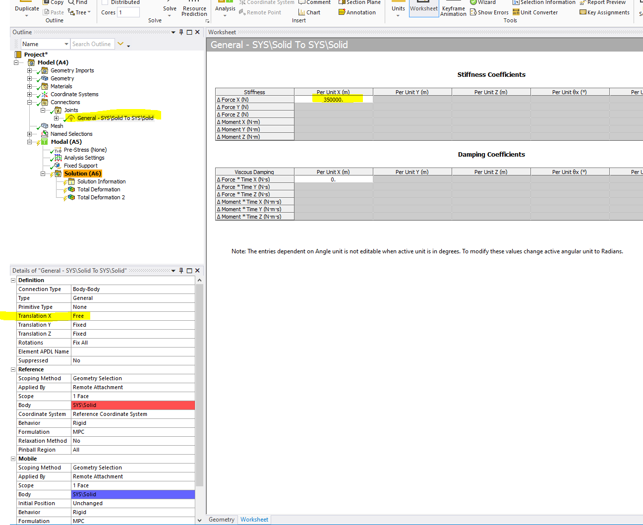

      Yes, the bearing element combi214 is 2D and used for lateral rotordynamic studies where the stiffnesses are in the plane perpendicular to the axial.
      In your case, we can use a spring/damper to represent Thurst bearing. You may use a general joint with the axial DOF set to free and add a stiffness value in the axial direction. Or use a bushing bushing element as convenient.
