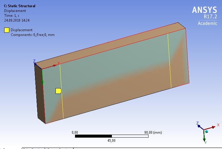

      Here follow some screenshots from the models:

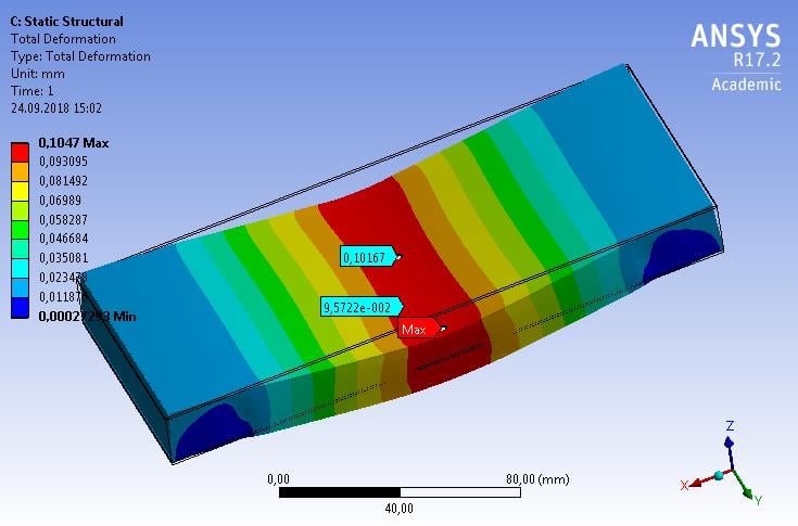

      1)

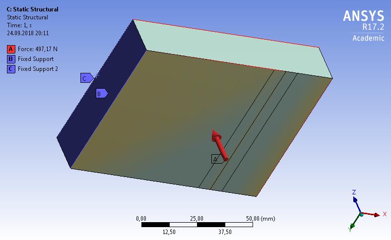

      Force Applied in an Area : 25x75 ,  force direction along Z axis:
      Displacements applied along two lines at a distance between them of S =150, Displacement condition Z=0:
      Results in total deformation, z = 0,1288 upper face at the center /  z = 0,123 under face at the center:
       We can see that the deformation is not symmetric and there are rotations happening.
      2)
      Same Force
      Changing the BC's:
      Displacements applied along two lines at a distance between them of S =150, Displacement condition Z=0, X=0:
      Results in total deformation, z = 0,102 upper face at the center /  z = 0,096 under face at the center:

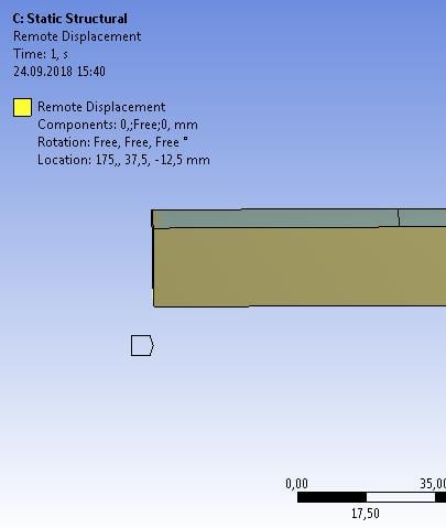

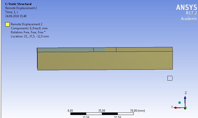

      Changin BC's to remote ones each time from a distance of 12,5mm away from the specimen because of the 25 mm  roller diameter suggested in the C393 ASTM.
      Remote Force Applied in an Area : 25x75 ,  force direction along Z axis, Scope from point in the center and 12,5mm above the upper face, Behavior: Deformable:
      Remote Displacements applied along two lines at a distance between them of S =150, Displacement condition Z=0, Scope from point center of each line and 12,5mm under the lower face of the specimen, Behavior Coupled:
      Results in total deformation, z = 0,126 upper face at the center /  z = 0,120 under face at the center:
      We see again that the deformation is not symmetric..

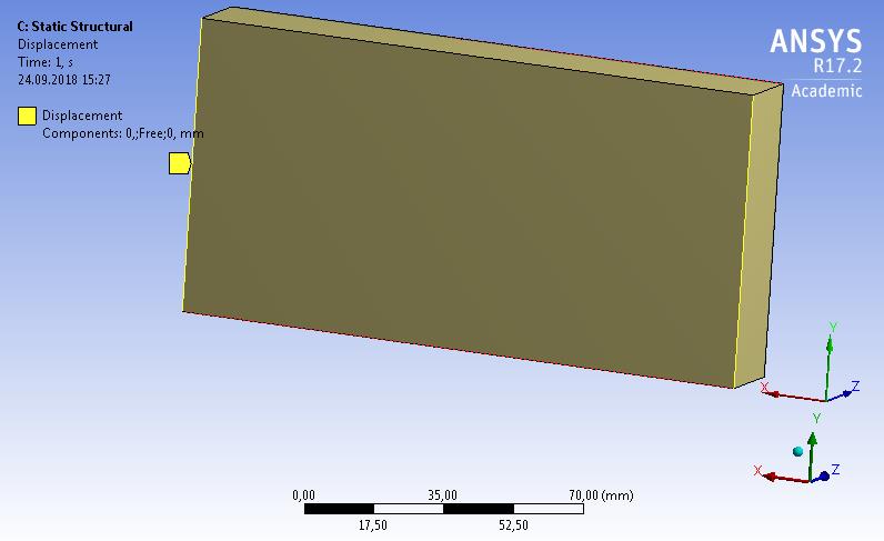

      Not extended model.
      Results in total deformation, z = 0,148 upper face at the center /  z = 0,136 under face at the center:
      The deformation again is not symmetrical.
      6)
      Not extended model
      Changing BC's toi limit X deformation.
      Results in total deformation, z = 0,122 upper face at the center /  z = 0,116 under face at the center:
      We see that the deformation now is symmetric but we can notice it is different from the extended model.

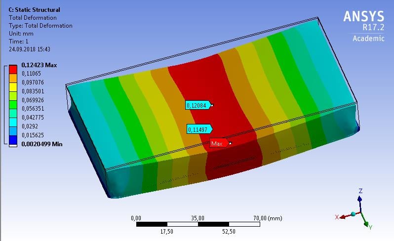

      Not extended model.
      Boundary conditions to remote ones and limiting also x deformation.
      Remote Displacements applied along two lines at a distance between them of S =150, Displacement condition Z=0-X=0, Scope from point center of each line and 12,5mm under the lower face of the specimen, Behavior Coupled..
      Results in total deformation, z = 0,124 upper face at the center /  z = 0,115 under face at the center:
      In Conclusion:
      Prefering the symmetric deformation plots-so limitating both Z and X deformation, we get close results between the models with normal bc's and remote bc's.
      W_max = 0,105 mm up, W_max = 0,096 mm down,    extended model
      W_max = 0,124 mm up, W_max = 0,115 mm down,   not extended model
      that is a difference close to 18% for the upper face and 16,5% for the lower face, between the extended and non extended model.

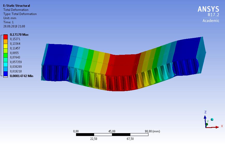

      8)
      Because in reality the supporting bars will result to an area of contact with the panel and not a line I also did a simulation where the displacements were set on two faces of an area 12,5x75 (diameter of 12,5 rollers bars) and not on a line, and of course I had different results: upper face w_tot = 0,089 mm and lower face w_tot=0,083mm..
      9)
      After the formulation of that link : https://www.uni-ulm.de/fileadmin/website_uni_ulm/uzwr/lehre-seminare/AdvMat-FEM/WiSe-2015-16/FE-Lab-1.pdf
      I also tried cutting the model in half and fixed the center face which remains vertical as stated in the theory and put a force on a line/ face in a distance of S/2 from the fixed center face with the half value F=497,165 N along the positive Z axis:
      I had also different results:
      Now I don't know why the theory doesn't much with the extended model, and why I get that bif difference with last number 8) configuration, where it is supposed to be the same.
       I have to choose one model but I want it to be as aforementioned the closer to the bending test formulation of the 3 Point Bending Test of  C393 ASTM.
      So the only thing missing is to run also a simulation with a non linear contact simulation.
      Can you help me?
      Gratefully,
      Achilleas

      Wow!  You have done a lot of work here. I have read it top to bottom and have the following comments to each of the quoted statements for the numbered sections.
      1)
      "since the model is basically simple, running time less than a minute, I didn't use the symmetry to take 1/4th of the panel."
      Peter> Symmetry is valuable for applying necessary constraints, not just for faster solve times.
      "Displacements applied along two lines at a distance between them of S =150, Displacement condition Z=0:"
      "We can see that the deformation is not symmetric and there are rotations happening."
      Peter> This is not enough constraints to prevent rigid body motion.  That is why you are seeing non-symmetric results and some rotation. There is not enough constraints. See my first point about using Symmetry.

      "Displacements applied along two lines at a distance between them of S =150, Displacement condition Z=0, X=0:"
      Peter> Now you have too many constraints. What you want is a roller on each end so you don't create extra tension between the lines on the bottom as the load is applied, which would not occur with real rollers. That is what you can have when you use two planes of symmetry and build a 1/4 model.
      3)
      "Remote Displacements applied along two lines at a distance between them of S =150, Displacement condition Z=0, Scope from point center of each line and 12,5mm under the lower face of the specimen, Behavior Coupled:"
      Peter> This is not enough constraints to prevent rigid body motion.  That is why you are seeing non-symmetric results and some rotation. There is not enough constraints. See my first point about using Symmetry. The 12.5 mm offset is not necessary.

    • AchilleasMil
      Thank you for your answer sir,
      1)

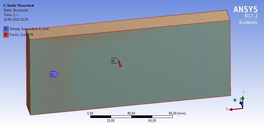

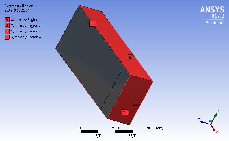

      I tried doing a 1/4th of the model where I set the following symmetry on two faces and two edges:
      Afterwards applying only a Z=0 displacement on the corresponding line and a normal force of F/4 on the corresponding  face I get:
      upper face w_tot = 0,147 mm nad lkower face w_tot = 0,14 mm
      After changing to remote force and applying a coupled behavior on the face I get:
      upper face w_tot = 0,122 mm nad lkower face w_tot = 0,120 mm
      Both have a difference from 10% or less from Literature results, but the second one is stiffer and the first one softer in contrast to analytic calculation of w_tot= 0,132 mm.
      Is the symmetry settup correct? I wanted to ask, is it enough for the program if I aplly the symmetry just in the edges or do I also have to set it on the faces as I did?
      2)

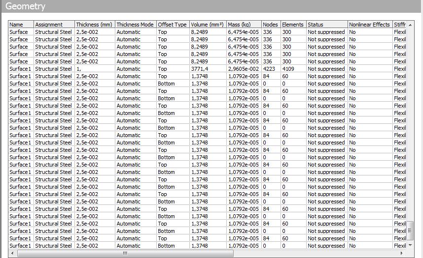

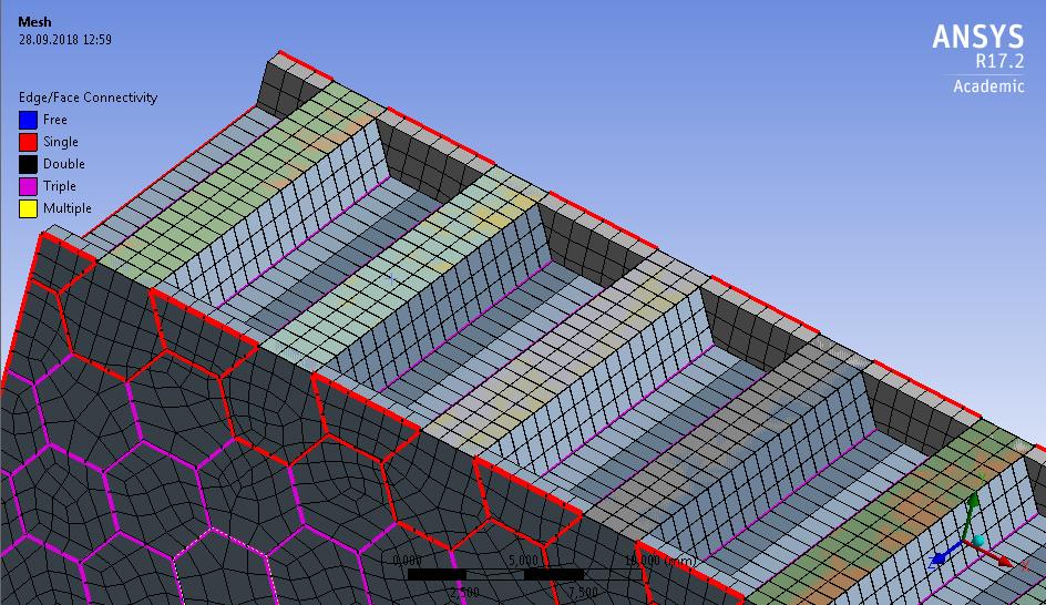

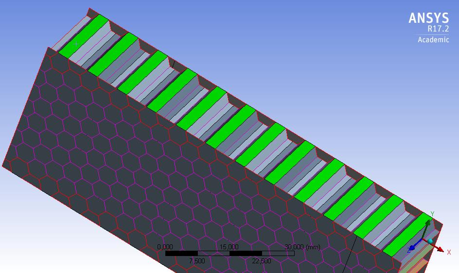

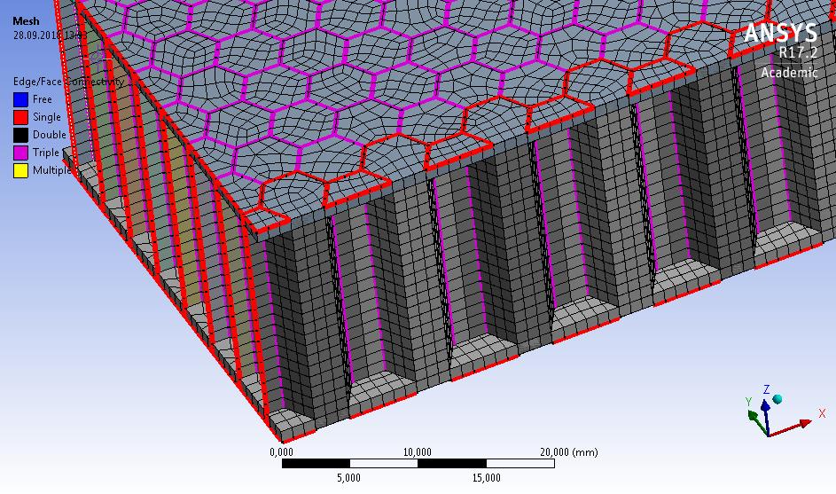

      I also tried do one simulation with a honeycomb model made of only surface bodies, but after cutting my model to 1/4 th and hitting run I get constantly the error that:
      'At least one body has no elements in it. this may be due to mesh based defeaturing of the geometry. the offending bodies can be identified in the worksheet view on the geometry folder and suppressed if desired'
      And I figure out that the following faces positioned exactly on the plane which cut my model in the width direction have not been meshed, and after trying I cannot fix that. They remain unmeshed.
      Do you know why that might be happening and how to solve it?
      Gratefully,
      Achilleas

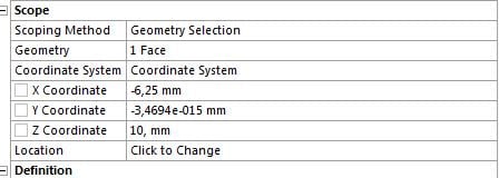

      Hello Achilleas,
      I'm glad to see that the two planes of symmetry are helping.  Yes, you need symmetry on the edges and the faces.
      Please show the location of the coordinate system that the Remote Displacement is using. It may not be on the center plane. It may be at the center of the face that was selected when the Remote Displacement was created. You have to move the Remote Displacement origin to the center plane after it is created. If you don't, it is as if you are doing a four-point bending test instead of a three-point bending test, and those will have different deformations for the same force.
      For the honeycomb model, go into Mesh Details and turn off Mesh Defeaturing.

      Yes you are right, I had it set on the global coordinate system and the point is shown in the middle of the face:
      I tried setting a new coordinate system by choosing the face where the specimen was cut lengthwise:
      And then set the remote force by that coordinate system but the result remains the same, and the point seems to be the same also:
      So the values remain the same w_tot_up=0,122 mm and w_tot_low = 0,120 mm..
      Also for the honeycomb I changed the automatic mesh based defeaturing off but still the faces remain unmeshed.
      Is there something else I have to change?
      Gratefully,
      Achilleas
      Achilleas,
      See where it says -6.25 mm for the X coordinate?  Type over that with a 0.0 and the force will be applied on the center plane.
      On the honeycomb, Clear the mesh, then with the Mesh branch picked in the Outline, right click on the face that does not normally get meshed and select Mesh Selected Body and see what happens.
      Peter
    • AchilleasMil
      Hi sir,
      Ok I changed the scope point for the remote force:
      and the results are the same:
      As for the honeycomb, I tried doing what you suggested and by showing the mesh in the display it seems that the faces are meshed, but I still got the same message after trying to run the simulation, so I went to the worksheet and again the specific faces had no mesh:
      I went to the selected items in the tree:
      and then hit show mesh again:
      there is a mesh displayed but there is no edge or face connectivity:
      The same connectivity is showed in the other side but there the faces have elements in the worksheet:

    • AchilleasMil
      Hi again sir,
      Found out what was going on with the honeycomb, there were doublicate faces remaining from after the cutting of the model to the 1/4 th.
      I deleted the duplicates and it run. I noted the symmetry of the model in these faces and edges which were on the planes who cut the panel lengthwise and widthwise into the final 1/4th of the initial geometry:
      I set the Axis normal to which there is the symmetry ( Y or X) and then got the following deformation plot displayed for the whole panel:
      It looks correct and is near to the analytical value, but I am not sure if I have set the symmetry totally correct, can you please tell me if I have set anything wrong in the symmetry setup?
      As for the remote point from which the force is scoped, I do not get a difference in the results by changing its location, should that be a problem?
