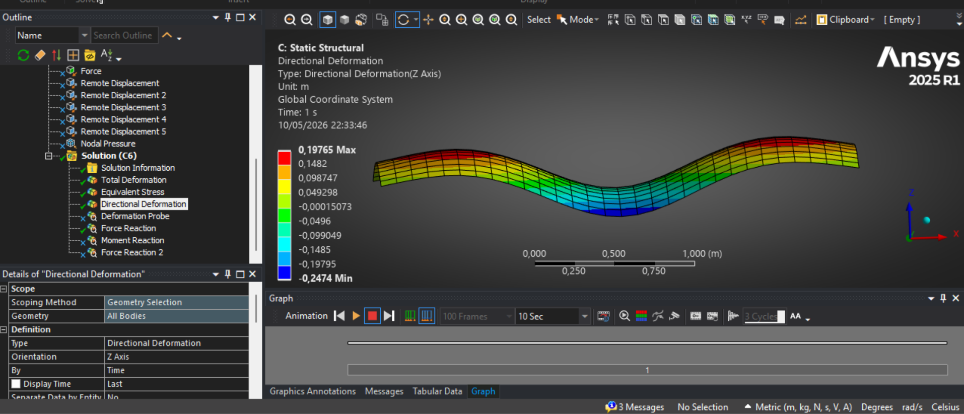

SubscriberI am developing an ANSYS Mechanical model of a thin flexible plate (SHELL181 elements) with free boundary conditions. Gravity is applied over the entire plate. To simulate handling, I apply equal and opposite distributed pressure over four symmetrically placed patches so that the total force balances gravity and induces bending deformation.
The goal is to use this ANSYS model as a reference (ground truth) to validate a Kirchhoff–Love plate PDE model implemented in MATLAB. The geometric discretization and parameters are kept consistent between base model and ANSYS.
In the base model:
- Linear Kirchhoff plate formulation (no geometric nonlinearity)
- Viscous damping proportional to velocity, normalized as:C/D=5 and constant on all nodes
to match steady-state deformation and damping behavior with ANSYS,
1. How can I select Rayleigh damping (specifically stiffness-proportional coefficient (β) in ANSYS transient analysis to match the base model damping term C/D=5 which is normalized by plate stiffness?
2. Should I use Static Structural or Transient analysis? Which is more appropriate for validating a linear plate model?
3. The structure is unconstrained, so I use weak springs: Without weak springs --> solution fails & with large deflection ON --> solution does not convergeIs it appropriate to:
- keep weak springs ON
- keep large deflection OFF (to remain consistent with linear theory)?
4. Upward prressure:
- Distributed pressure on patches introduces a small imbalance (~1e−3 N in Z)
- Remote displacement (Z=0, rotations free) produces different deformation
Which approach is physically more appropriate for representing gripper action in this case?
5. Current results:
- Max deflection ≈ 0.198 m (consistent in static and transient analysis with β = 0.75)
What are recommended criteria or checks to ensure that:
- the force balance is correctly represented
- the deformation result is physically consistent and suitable as a reference for validating a reduced-order plate model?

However, in my case, the MATLAB model is already based on the formulation from the reference paper (), where the parameters are normalized (e.g., ρ(mass per unit area)/D(stiffness) = 2), and my goal is not to verify the discretization itself but to calibrate the stiffness parameter using ANSYS as a reference.
So my current approach is:- Use ANSYS as a “ground truth” model with physical parameters (E, ρ, ν, h)
E = 7 × 10^10 Pa
ρ = 2700 kg/m³
h = 0.00046 m
ν = 0.3
- Ensure these parameters satisfy the normalized ratio used in MATLAB (ρ/D = 2)
- Apply the same loading scenario (gripper patches + gravity)
- Compare steady-state deformation
- Tune a stiffness scaling factor in MATLAB until the deformation matches ANSYS
My questions are:
1) Is it correct that benchmark problems are not necessary for my current goal (since I am not validating the numerical scheme, but calibrating model parameters)?2) In the MATLAB model, the boundary conditions are fully free, and gravity is balanced by upward forces applied over four symmetric patches (gripper regions).
To replicate this in ANSYS, I considered two approaches:
- Applying distributed pressure over the same four patches (to balance gravity), with weak springs enabled for stabilization- Applying remote displacement at the four patches (Z displacement fixed, rotations free)
Which approach is physically correct and more appropriate for this scenario of distributed pressure with weak springs, or remote displacement constraints or other which I should explore?If you need any additional information, I will provide it promptly. I am currently exploring applicable options, and your guidance is extremely helpful in clarifying the right direction.
