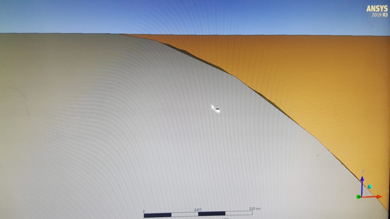

      Ribs were made using edges from the skin. However, once we zoom in a little, we can see different edges of each surface. Does that mean by edges are not connected? I tried using repair tools as well. Sometimes it seemed to work as edges merged together but it did not solve my contact problems.

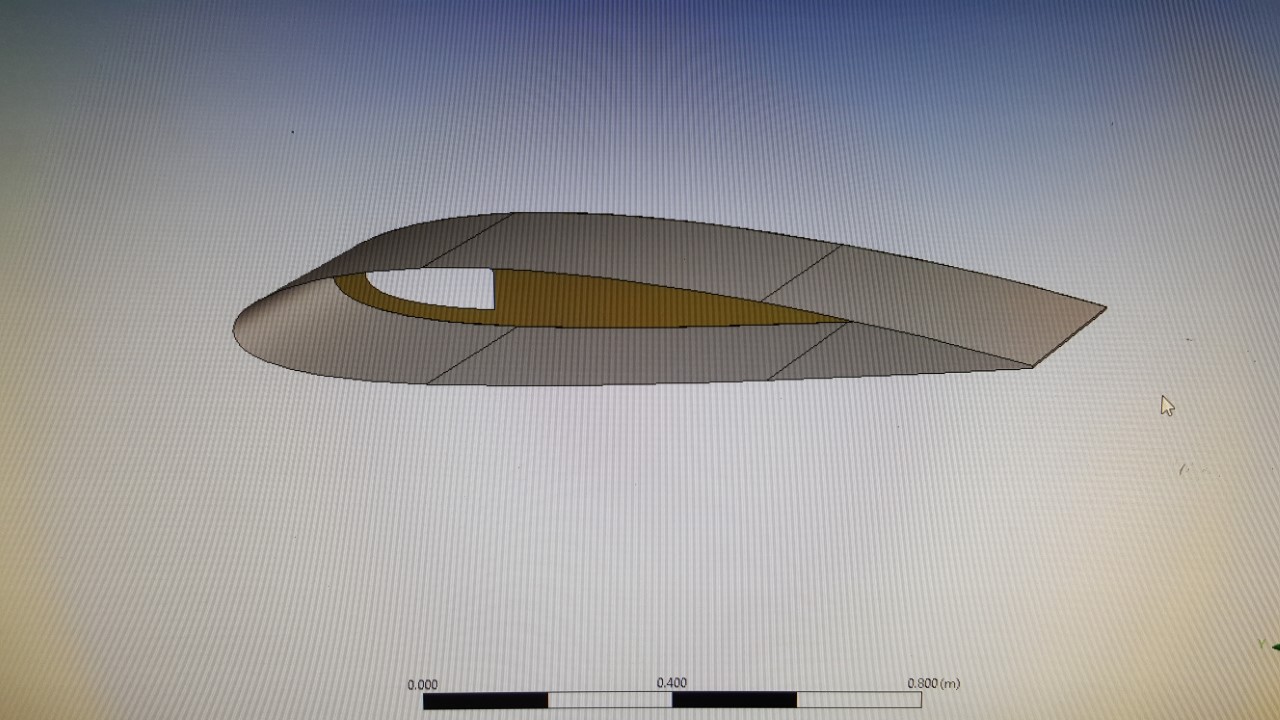

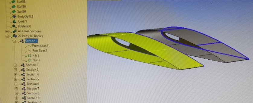

      As shown in the attached figures, a single section consisted of skin (surface body), two spars (Line body- Two lines on top skin surface), and a rib (surface body). All were put in a single part. However, when I took that single part in Mechanical, a applied a load on one end (at rib) while fixing the other, the rib detached from the skin at some locations. However spars and skin were well connected.
      Single wing section
      Section 1 and Section 3 are shown here. (Section 2 used for joining them is hidden for clarity)
      But then I went back on DM and created "Joints" (Tools>Joints) by selecting all 4 bodies in that part. It worked as can be seen by "Edge joints" view in Figure. Also worked fine in mechanical.

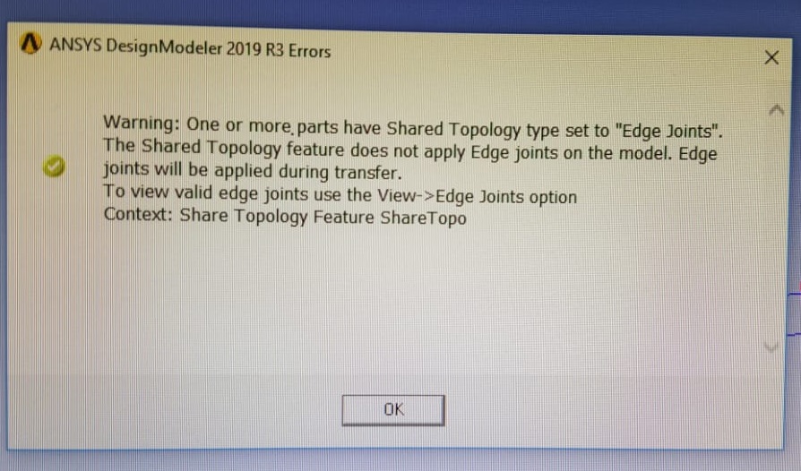

      Edge Joints are essentially coincident edge pairs that are tracked in the ANSYS DesignModeler application.
      They are created automatically by several features, such as the Surfaces From Edges and Lines
      From Edges (p. 424) features. Edge joints can also be created by the Joint feature, where you choose
      a set of bodies to join together. Edges that are paired in an edge joint must belong to bodies that
      reside in the same part in order to share topology. During transfer of the model out of the ANSYS
      DesignModeler application, each edge joint will combine its coincident source edges into a single
      edge. The edge joint method cannot be applied to Solid (p. 195) bodies.
      Above is quoted from Designer Modeler Manual.

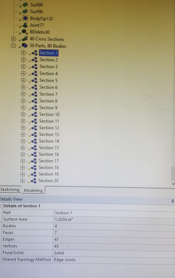

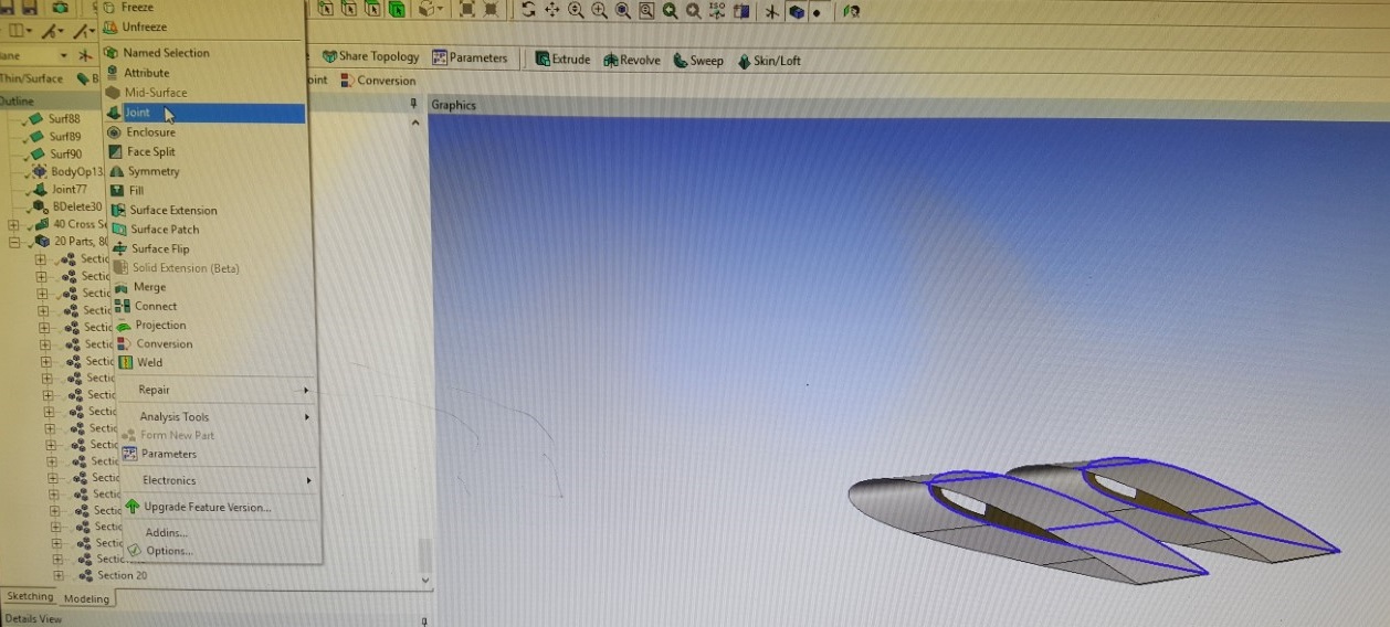

      Shared topology just doesn't seems to work for me. I made my whole geometry into a single Part and applied Shared Topography (It only shows me option for edge joints) . Once generated, it has no effect on the geometry (which is also visible from the yellow tick mark). Number of edges of the geometry remain same. (Share topography is done after merging all multi body parts together- Image below is taken before that).
      Is this because the edges are not same for different surface bodies. They were created from the same edge but once surface is created, if you zoom a little you can find different edges for different surfaces. Is this normal?
      Also I used the joints option from the DM, which seemed to have worked for me. Isnt there any difference between the Joints in Mechanical and Joints created in DM?
