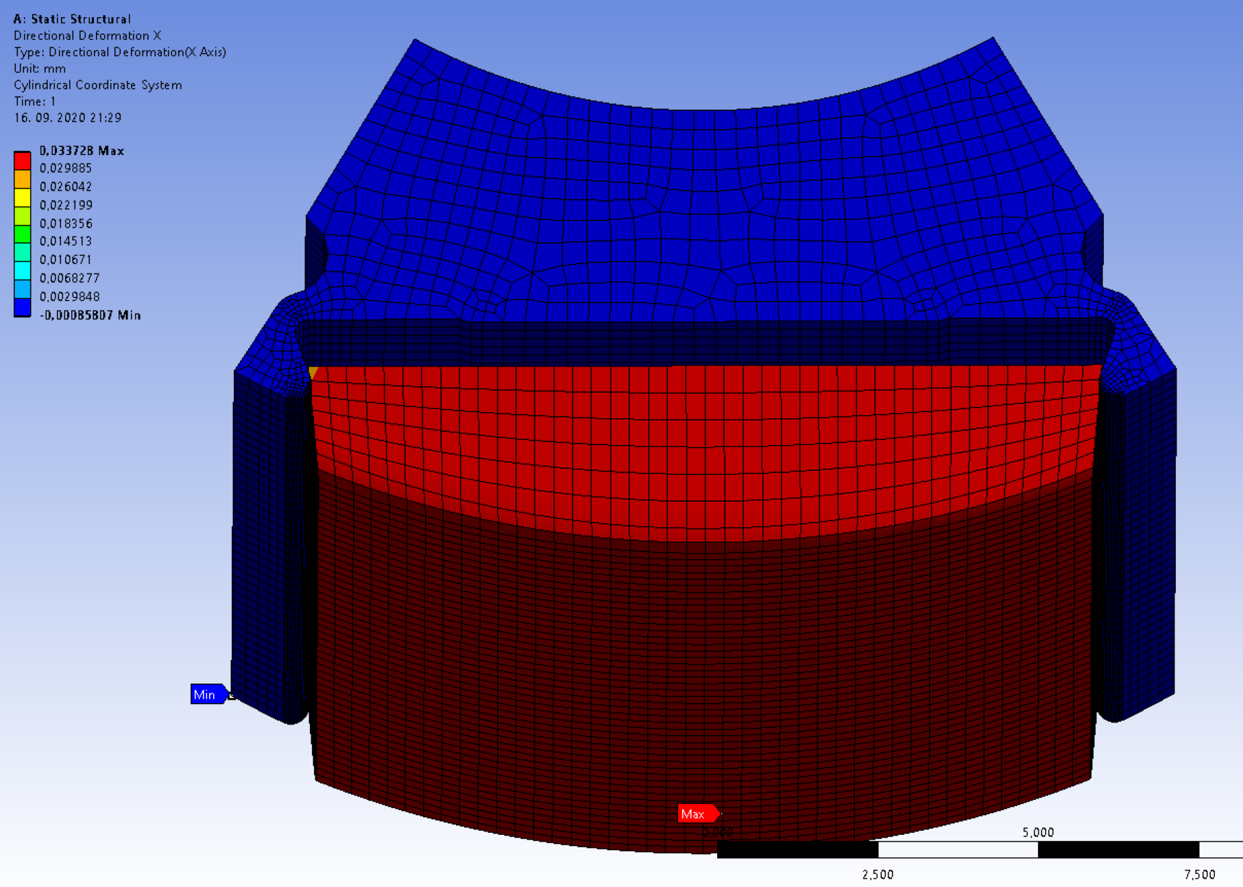

      Hello,nnso for the last few days I've been trying to make my model work, sadly without success. Bonded contacts helped, but gave higher radial directional deformation so I am not sure whether I should use them or not.nI decided to take a try on adding s small radius on sharp corners, just like you suggested. The problem occurs when I try to mesh the electro metal plate. Due to small radius I cannot seem to get structural mesh unless I partition that part. I did that in Space claim and set my Topology to be shared, so that nodes would correspond to partitions. After successfully meshing electro metal plate with hex elements I ran the simulation with only magnet and plate. Before that I have also run a simulation with plate and magnet only but without small radius on sharp corners. Here are the mesh and results:nAnd here are the mesh and results of exactly same simulation with added fillets (radius on corners) and thus needed partition for successfully meshing:nI really have no logical explanation for this. I double checked everything and tried multiple times with always same results. For a better understanding I am also attaching a model. Any help and tips are appreciated.nnThank you!nn
      There is a lot of support missing when you suppress the green injection molding part. With the molding, the fingers around the magnet are supported by a layer of PPS that is in compression between the two fingers, as well as the layer of material that develops hoop stress to support the magnet.nWhen the injection molding is suppressed, the support retracts to the central core of the electro metal plate and the fingers are free to flex out. This causes high stress due to the small wedge angle on the magnet, and there is no layer on the outside to support the magnet.nYou need to add a blend fillet to this edge of the injection molded part...n...to match this fillet on the electro metal plate.n
    • Bukovnik
      thank you for the answer.nHowever I am not sure you understood what I meant. My problem is that adding a small radius (0.05 mm) on the electro metal plate completely changes the behavior of whole model. Despite the similar mesh, results are not logical. On the first result image magnet flies away, as expect. It flies away by 0.033 mm due to centrifugal force. That in my books seems completely logical. However on the second result image the magnet doesn't move at all. Even more It seems like that electro metal plate moves IN magnet and magnet is standing still. To double check: it is completely same simulation with a difference of added small radius in second simulation. I do not know how to explain that behavior.nHope any more tips can be taught of.nThank you.n
    • Bukovnik
      Peter I cannot thank you enough for clarifying this for me. Makes more sense now. Currently I am running a simulation with added Injection molded part without thermal condition so far. I've added fillets. If simulation runs well I will added a thermal condition and post results to see if it solves the singularities problem.n
