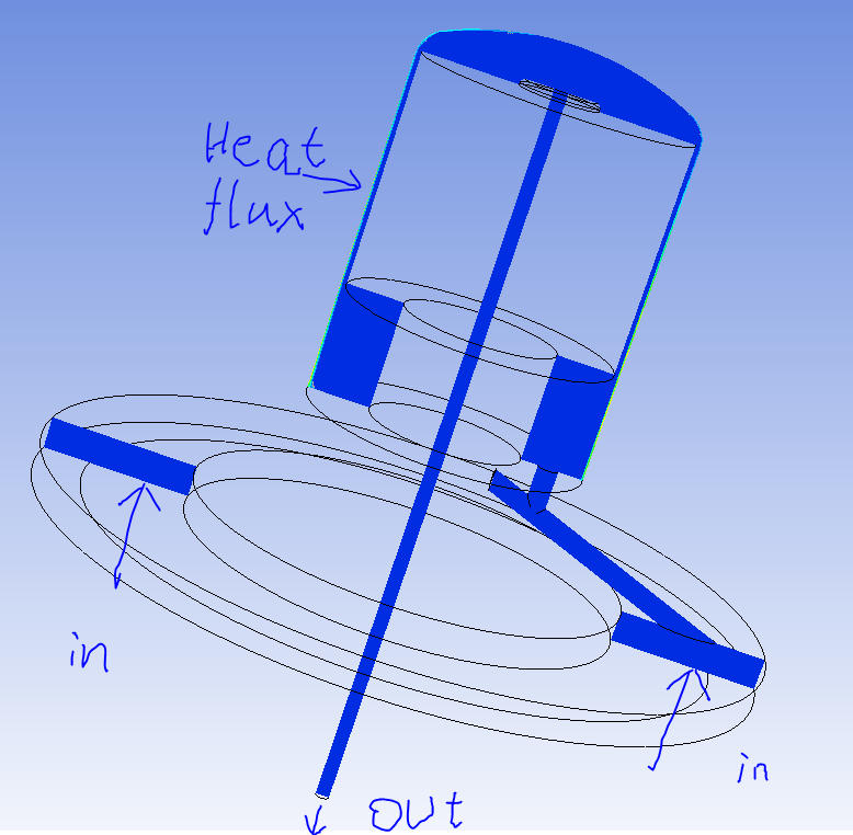

      Hi Guys
      I want to simulate the cooling systerm design for magnetic coupling in pumps using CFX. In CFX-pre I set inlet/outlet pressure, heat flux on outer sylinder surface.
      And I want to get the cooling flow out of outlet and tempreture on outlet surface.
      Simulation can run but the iteration is not convergent after several steps, no matter in steady or transient run.
      Do you have any suggestion for this such kind cases? Very appreciate.

      Hello Steven,
      I recommend you to try modifying the TimeScale value (In "Solver-Control" option) and check it. I am attaching a best practice tutorial file regarding pump in cfx. Please refer to these links for appropriately setting up the case.

      • stwu
        Dear Chaitanya
        Thanks for your suggestion, I change TimeScale to 1/rpm instead of auto timescale, then it works.... Thanks a lot...
