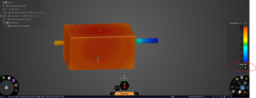

      In discovery I can see how long a part will take to cool by using Time dependent Thermal Analysis.
      See attached part and set up.
      Is it then possible to add a cooling channel and see the effects of this? For example I would want to see areas of undercooling and overcooling.
      This is a very basic model but the principles would be the same on a more complex.
      I thought this may be CHT analysis but I don't seem to get any results that seem reasonable.

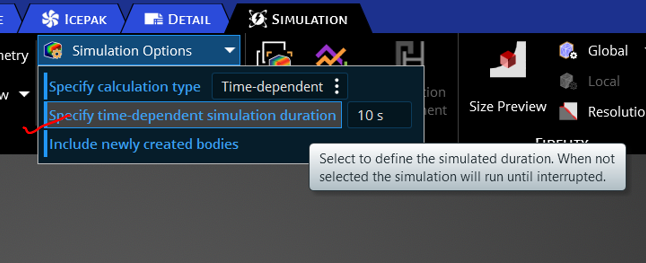

      For Time dependent analysis you will need to specify time-dependent simulation duration else the simulation will continue until it is interrupted.
