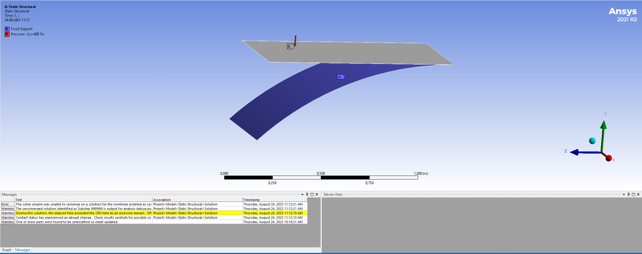

      hello, i am unable to converge the solution of an non linear problem where I use a thin glass to bend onto to solid body which is fixed.
       1/4 system taken for solving using symmetry regions and with a mesh size of 0.02 m.
      I am using frictionless contact and with a fixed top surface of sub-structure and surface pressure on the bottom face of the thin glass.

      Have you checked the large deformation is "ON"? How many substeps you have used for this simulation?

      hello sampat yes i have used the large delfections on and i have tried using 10, 50, 100 substeps.

      See this discussion for help with convergence (go through all of the video).
      https://www.youtube.com/watch?v=sZf5p_evqOk
      https://www.youtube.com/watch?v=O-qTAiE8Kdo
      Finally I would apply the pressure on the surface load and consider making the curved part rigid body instead of fixing all displacements. Also consider using 1/2 symmetry so you have both sides (so mirror it along XY plane) of the rigid form and the glass panel.

      As Erik correctly mentioned, using 1/2 symmetry and the application of the boundary conditions will help you get the required convergence result. Also, you can follow the attached video, which will help you understand better.
      Apart from this, I am suggesting some points that might be helpful to simulate this problem. Please change some contact settings and let me know if it worked or not.
      1. Make the contact behaviors Symmteric and apply the trim contact “off”.
      2. Turn off the ” small sliding”
      3. Select the Add offset, and Ramped effect in the interface treatment.

      I have edited it and changed some contact changes but still i cannot converege the solution. so i have attached link to the file here may be this would help understand. I will go through the video provided and anlayse much further now.

      hello Sampat, thank you for the update my main issue here I guess is that my top body even with symmetry the body is not getting constraints and moving in different directions. so, is it good if I create a hollow box around it initially and use that body as a solid rigid body?
