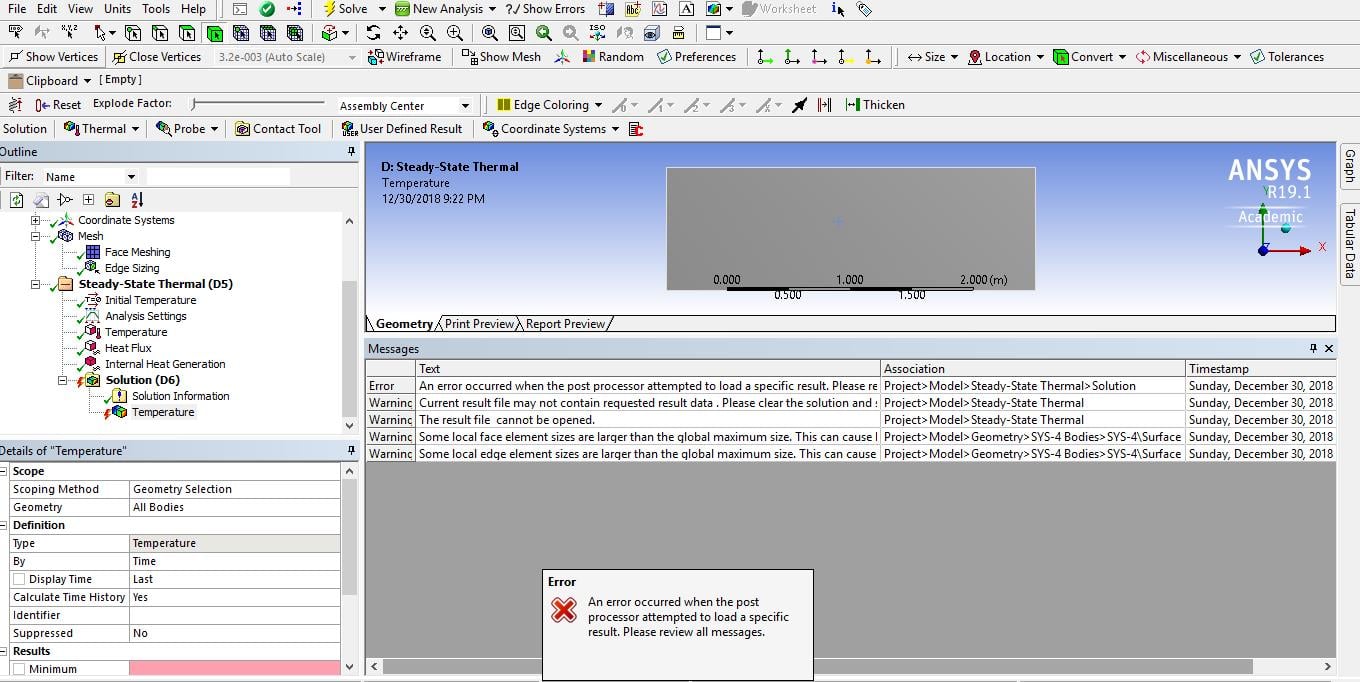

      When i try to solve any problem in ansys i get empty blank without any results and can't get any results in the solution
      Aszem,
      It solved just fine. Delete your Temperature result under the Solution branch and create a fresh Temperature Result. You will see your result.
      The error message is telling you that you are requesting a time in the Temperature result that is not in the solution. Just delete it and make a new one.
      Peter
      If this answers your question, please click Is Solution below or ask a follow-up question.

      So you get a solution, but as soon as you add a result plot, it generates this error.
      I recommend you uninstall ANSYS 19.1 and install ANSYS 18.2 for the duration of the edX course.
      You will have to discard all your models made in 19.1 as they won't open in 18.2

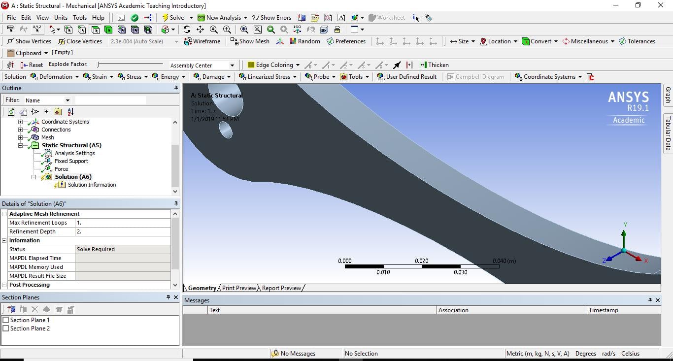

      i also make simple problem like a rod fixed and there force bulling it and try to get solution but also nothing !
    • Aszem
      i installed the 18.2 version but also get the same problem just worked once and after not work again
      is it windows problem or what ?
    • tsiriaks
      Also, make sure you have read and write permissions under your project directory.
      Or you can try moving your project files to some other path (like C:Temp) and solve again.
