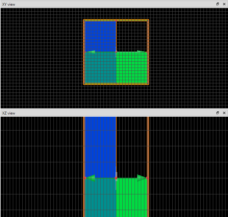

This really depends on the structure. I would use a magnetic dipole to try and excite TM modes, and to excite TE modes use an electric dipole. This assumes you know how TE and TM will be polarized in your device and that you have aligned the dipole axis in this orientation. For these dipoles the symmetry should be set tangential to the dipole axis should be the same color, and opposite color would be normal. This is outlined in this article.

Yes they will. If you use symmetry then you will have an image dipole, so yes they can. Again compare with and without to validate your set-up.

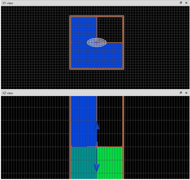

What is the polarize direction of the dipole source? I noticed that there's a gray cloud region around the dipole source, does it represents the propagation direction? And, there's also two reverse arrows, are they represent the polarization direction?

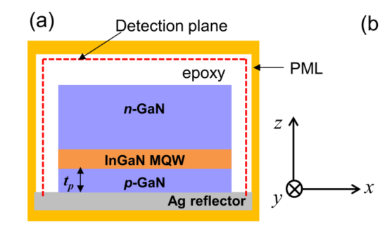

The light in our structure propagates to any direction, so it is not like a fiber or a waveguide. We assume? that if the light propagates vertically, it is the TE mode. While horizentally for the TM mode. And the reference coordinate system is shown in the below figure. How to recogenize the polariationze situation her? e

Ansys EmployeeHello Alexanderphenom The electric dipole will have the electric field polarized along the dipole arrow axis. The grey rings around the dipole indicate the direction of maximum emission. There are is also a small box, this indicates the actual mesh cells used for the excitation.

Your set-up looks correct. In this coordinate system you can add the contribution from an X and Y polarized dipole for each position (x,y).
