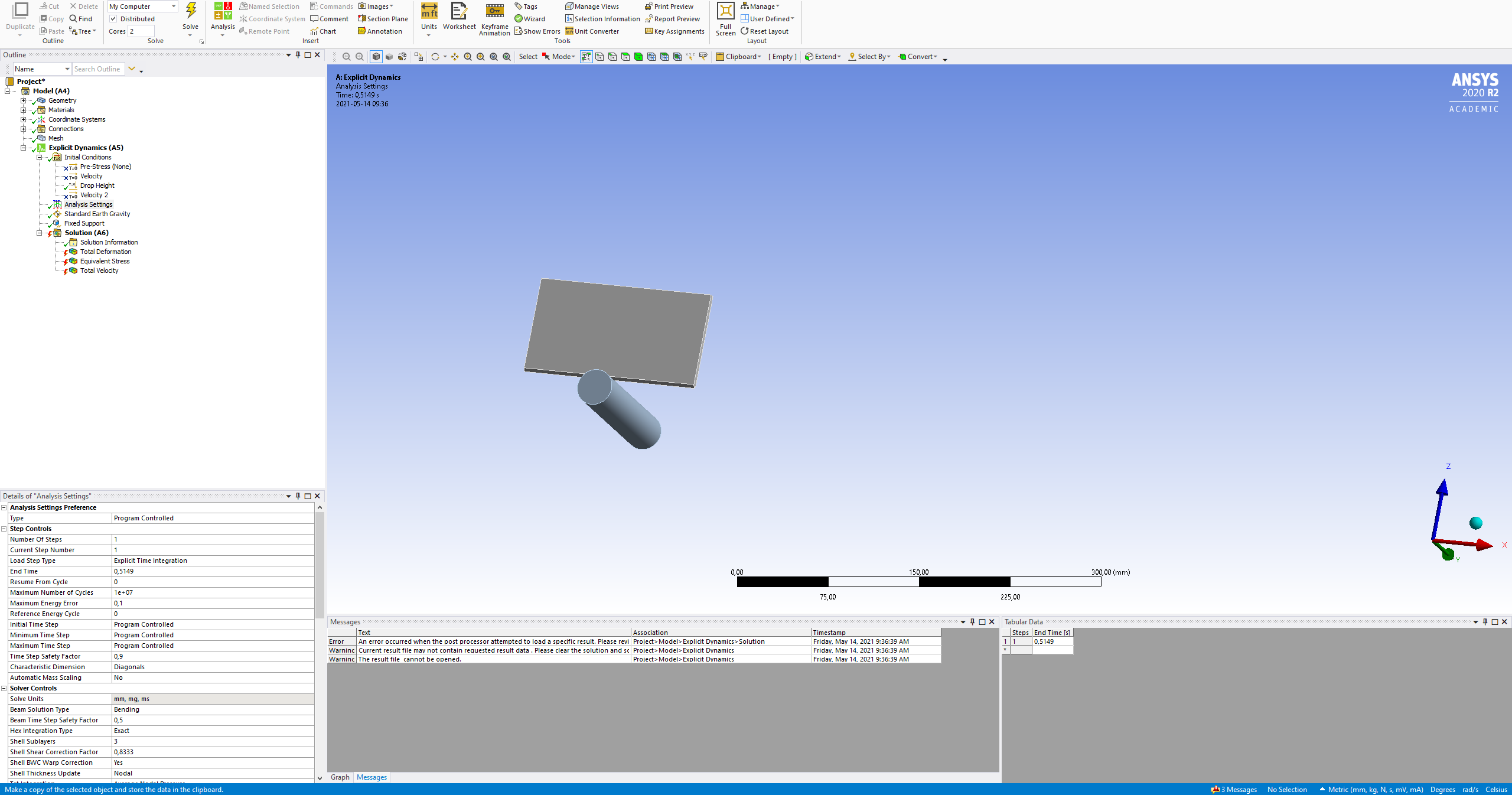

SubscriberI have an issue with static structural calculation, i am getting the resullts done but whem i am adding deformation and stress for evaluation, i am getting errors as shown below:
Error: An error occurred when the post processor attempted to load a specific result. Please review all messages.
Warning: Current result file may not contain requested result data . Please clear the solution and solve again.
Warning: The result file cannot be opened.
The model represent a guillotine mechanism, a falling knife on a branch to evaluate the deformation and stresses on the Knife.

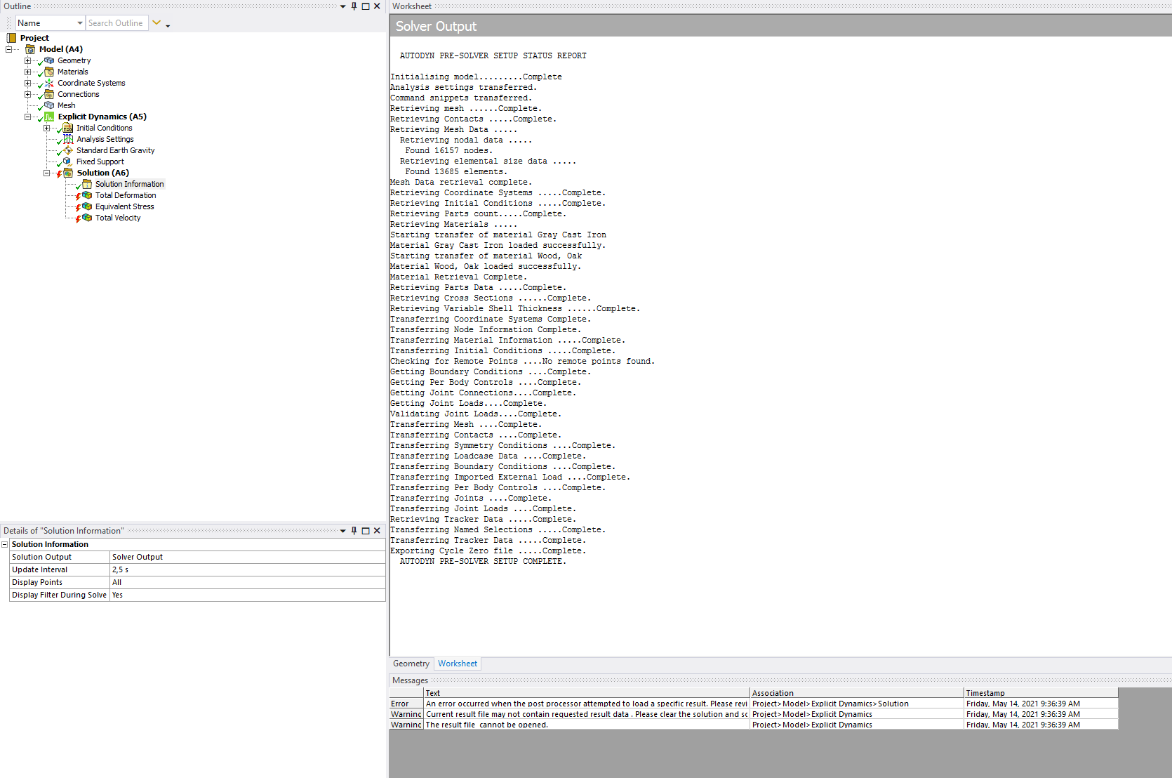

1) if you got this via an archive file or move the main workbench file away from solve directory, I guess you need to clear the generated solution and data and solve the entire model.
2) if you could able to show us the solver output, it shows the reason for such termination errors.check solver director if solver output is not visible (.out file)
cheers, Ram

SubscriberI tried to run the simulation while deactivating "distributed" in the solve field, it started to solve but stuck on the 5%.
I have an INTEL core i5 9600K (6 cores) if that might help.
