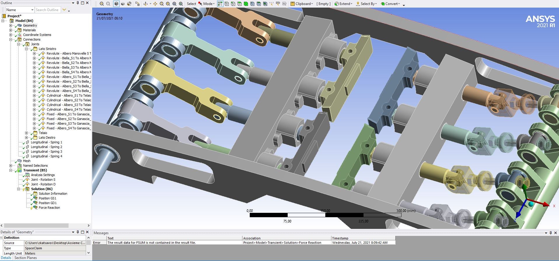

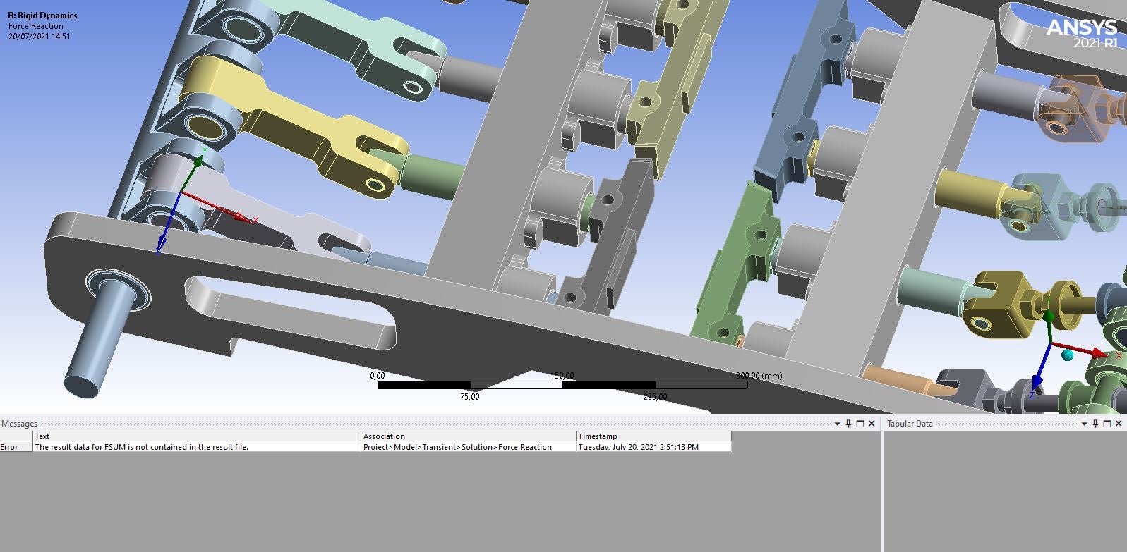

      Hello, I'm trying to simulate a press moved by a cranckshaft mechanism with Rigid Dynamics approach. The simulation has reached the end with no error messages and the motion simulation "looks real". I wanted to detemine the force reaction between the crankshaft and the connecting rod but I received the following message: "The Result data for FSUM is not contained in the result file". I evaluated the results, but no changes. I relaunched the simulation but, again, I couldn't obtain any result. I politely ask for an help.

      I assume we talk about a force reaction probe?
      Go to analysis settings, and Output control and set all to yes, then rerun (clear generated data first)

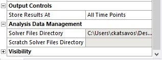

      I don't understand which options should be set to "Yes" in Output Controls.
      Thanks again Christian
    • erik.kostson
      Ok, there are none option for rigid dynamics - that is fine.
      It is a bit confusing, you are showing rigid dynamics, and the error message says Solution -> Transient -> Force -> Reaction.
      So FSUM is used in APDL solutions, say static or transient structural systems(flexible stress analysis not rigid dynamics), do not think this (FSUM) exists in rigid dynamics systems.
      Can you show exactly what you are doing because it is very confusing - please show all systems (rigid dynamics and so on), and perhaps someone can understand better.

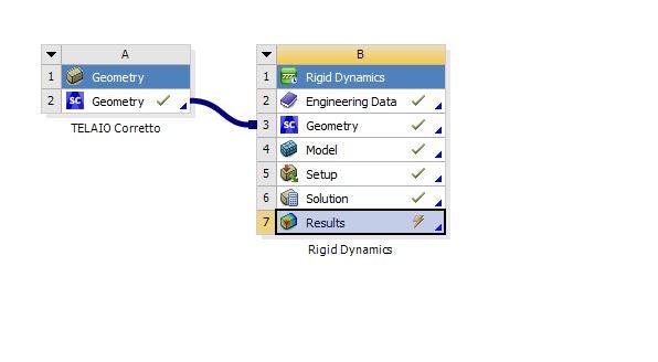

    • christian.katsavos
      Hello Erik.
      I dont know the reason why the path indicates "transient". Its a rigid dynamics simulation. I try to provide you with all the informations I have... If there still something I can do, feel free to ask. Thanks so much again for your kind collaboration.

      Do you have any flexible bodies (you should not be able to), and can you show the details of the force reaction probe?
      Since you have also joint rotation, use the joint reaction probe instead.

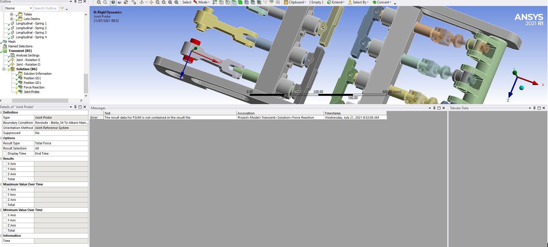

      I tried Joint reaction Probe:
      I obtained the very same error message. I also re started the simulation. It arrived to the end but the error message is always the same...

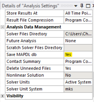

    • ic1
      Hi Christian I just had a similar problem ÔÇô I cahnged the "Save MAPDL db" setting to Yes and the problem went away

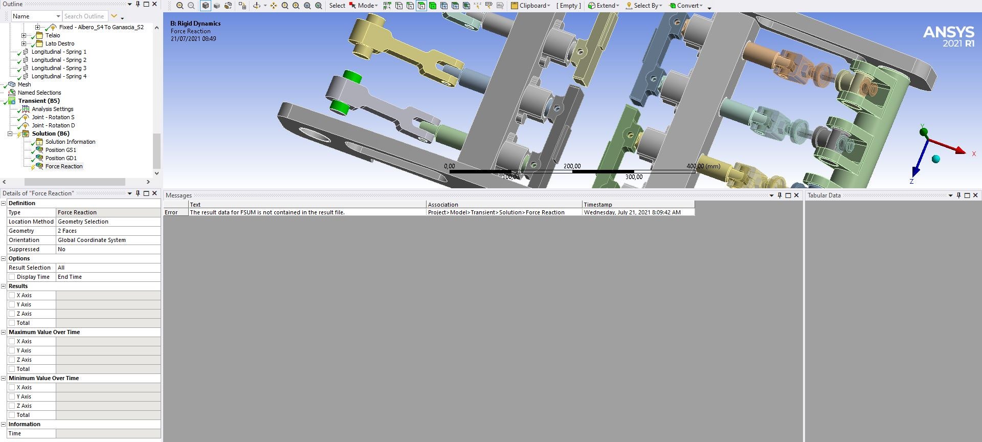

      Hello IC1 thanks for your help, but I dont understand how to make available the options visible in your "Details of "Analysis Settings". Have a look at mine:
      As you can see, for me Save MAPDL db option (as many others) is not visible... I've gone to "Options" and then to "Analysis Settings and Solution". I've selected "YES" in "Save MAPDL Database", but it is still not visible inside the Analysis Settings window".
      Any tips to make all those options available?
