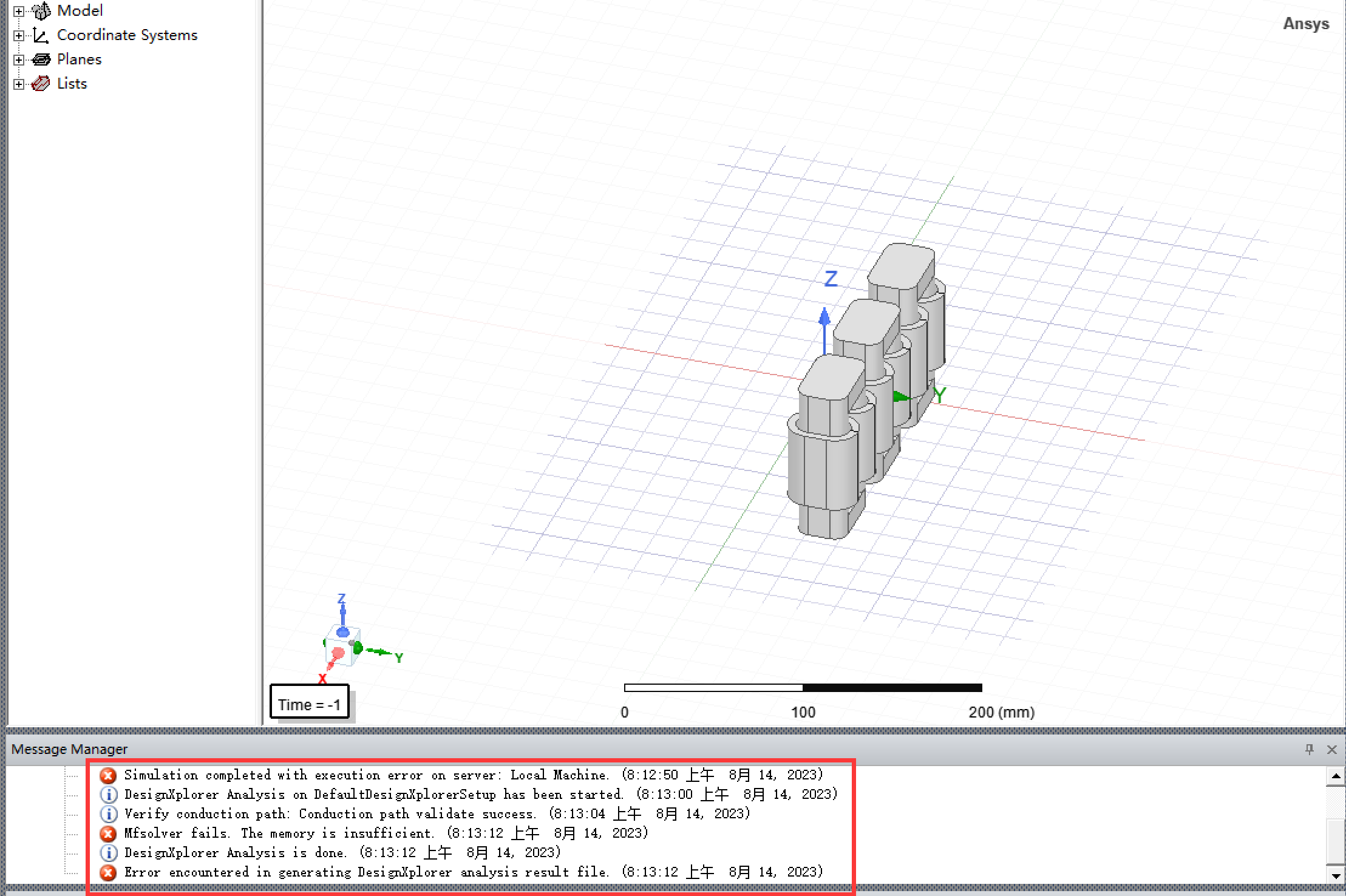

      I am running a transient simulation on a 256GB memory computer. But it indicates that the memory is insufficient in figure1.

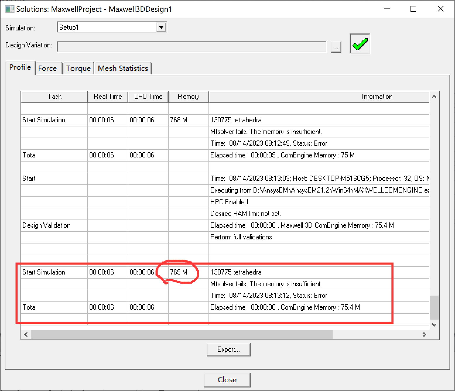

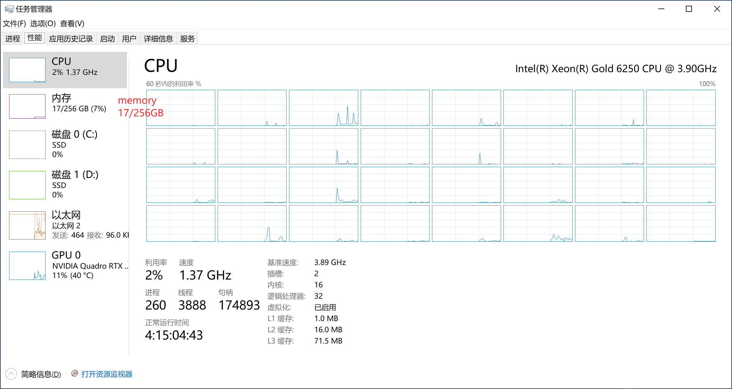

      figure2 shows that 130775 tetrahedra take up around 768 MB, meaning that memory is far from being crowded out. What can I do? There is no initial mesh setting.

      From the profile I see you are using the version 2021R2. This might be a bug in that version.
      Please use the latest available version 2023R2. If still facing the problem please submit your design to Ansys Support under customer.ansys.com
    • Zheng Lu
      Ehh…… Thanks for your reply…… Actually I found that the error occured when I import geometry model from solidworks……I do apologise for troubling you……
