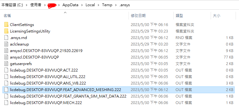

      Dear Sir/Madam,
      Upon reinstalling to the newer version of ANSYS (from 19.2 -> 22 R2) I ended up obtaining the error message as suggested in the title of this post. I have tried cleaning up any residual files from the previous version and had my devil dance with the Client Licensing Settings, still obtained no resolution. Could anyone help me run any diagnosis to identify where exactly is the problem?
    • VJ
      Hi David, are you pointed to a license server correctly?
      If you open the licdebug for ADVANCED_MESHING.222 in Notepad and scroll down, what error message do you see?
      Can you try going to %appdata% and renaming the Ansys folder to Ansys.old.
      Now try relaunching the application..
    • MangeshANSYS
      First, please contact the license server administrator and have them verify if a license that supports Ansys 2022 R2 is available on the license server or not. secondly check the error seen inside the licdebug file highlighted in your screen shot. share any error codes seen in error messages
