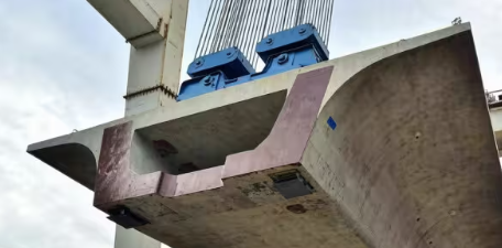

      I want to calculate the force/moment summations of all elements on a specific cross-section in the local coordinate system.I am thinking of first defining the points at which to sum the moments in the global coordinate system, then switching the resultant coordinate system to the local coordinate system, and finally calculating the resultant force. Would this approach work? csys, 0 spoint,,x,y,z rsys, local coordinates fsum, rsys

        Similar to a single-box, single-cell concrete box girder, the force/moment summations of the cross-section need to be determined under a uniformly distributed load.
    • dlooman
      It might be helpful to run a test on a simple model with a known solution.
    • dlooman
      The time-tested method of getting the resultant forces at a section is to select the elements on one side of the cross-section and the nodes at the end of the selected elements as shown below.
