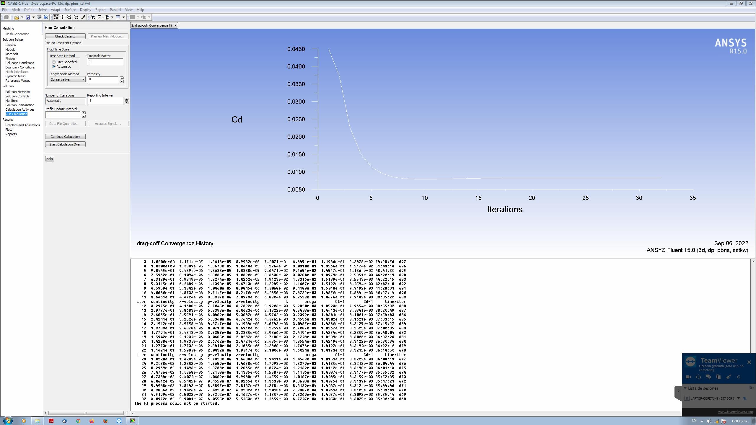

thank you for your response. I have used serie-processing as you recommended me, but the result is the same.Â
The simulation stopped (at iteration 32) and shows the following legend, "the fl process could not be started".
I would like to know what I am doing wrong to fix this problem ¿Could you help me again, please?

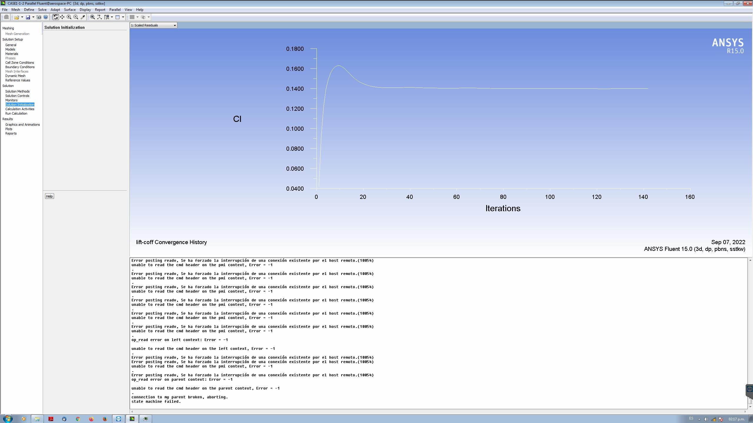

Considering the parameters my mesh is acceptable, I upload the image where is shown the legend that fluent shows when it stops. Also, about your question if I am using UDFs, for this case I am applying some equations to help the simulations. I use four equations with a total of 1500 iterations, being 700 of first order and the rest of second order.

Forum ModeratorI may question the resolution in the area of interest but the cell quality looks good. I'm slightly suspicious of any monitor that flatlines in under 10 iterations unless it really is a box with symmetry around the perimeter! The velocity residuals are also a lot lower than I'd expect that early in the solution.Â
Can you check RAM usage, and confirm if you're running over a network. There doesn't look to be anything causing a problem in Fluent that's solver related, so it may be external.Â

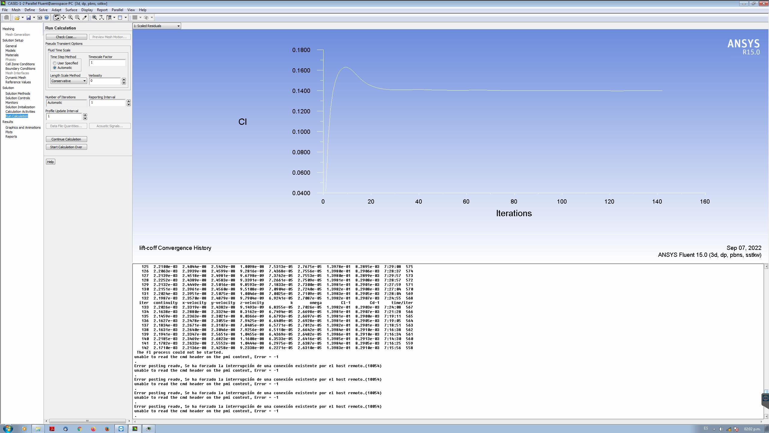

SubscriberHi Rob,
thank you for your response. I checked the RAM usage and it was of 25%. Sorry, but I don't know exactly what means "running over a network". I made another iteration turning off the web and the next happened. (images uploaded)
I have a doubt, those flat lines that you mentioned, are like that because a parameter that I introduced. I mean, maybe values that I am putting are making these lines being flat at first.
