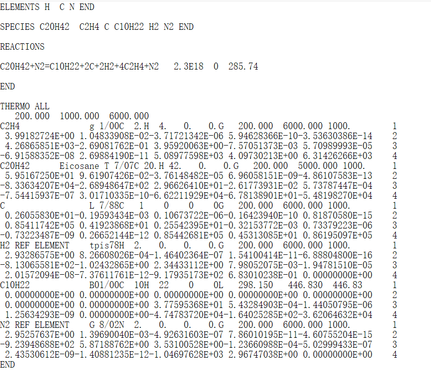

SubscriberI'm trying to import a CHEMKIN reaction mechanism into FLUENT, but there are always some problems, sometimes the FLUENT turns itself off, sometimes it's the same as in the image below.

Ansys Employee1/Which mechanism files are you reading?n2/In Which Version?nMarch 31, 2021 at 11:40 amMarch 31, 2021 at 11:50 amDrAmine
Ansys EmployeeIs Fluent writing any out files in the directory you are trying to read the mechanism? Can you check them (asc.out, Kineticxxx) nMarch 31, 2021 at 11:51 amDrAmine
Ansys EmployeeMechanism looks weird or simple. only one reaction? nMarch 31, 2021 at 11:53 amEason_23
SubscriberYes, because the exact mechanism of the reaction is not clear, it's just a simple mechanism.nMarch 31, 2021 at 11:56 amEason_23

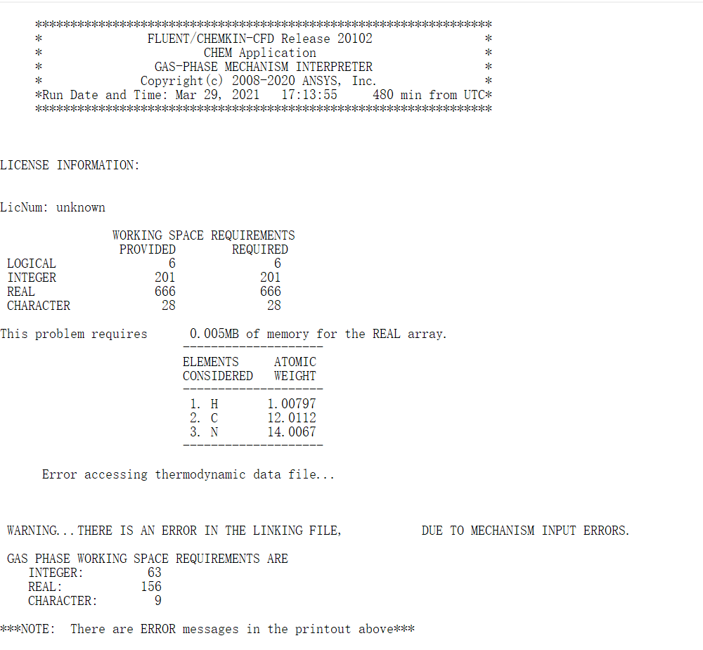

SubscriberThis is the chem.out file.n
n
March 31, 2021 at 11:57 amDrAmine
Ansys EmployeeIt is stating: Mechanism Input Error.nMarch 31, 2021 at 12:00 pmEason_23

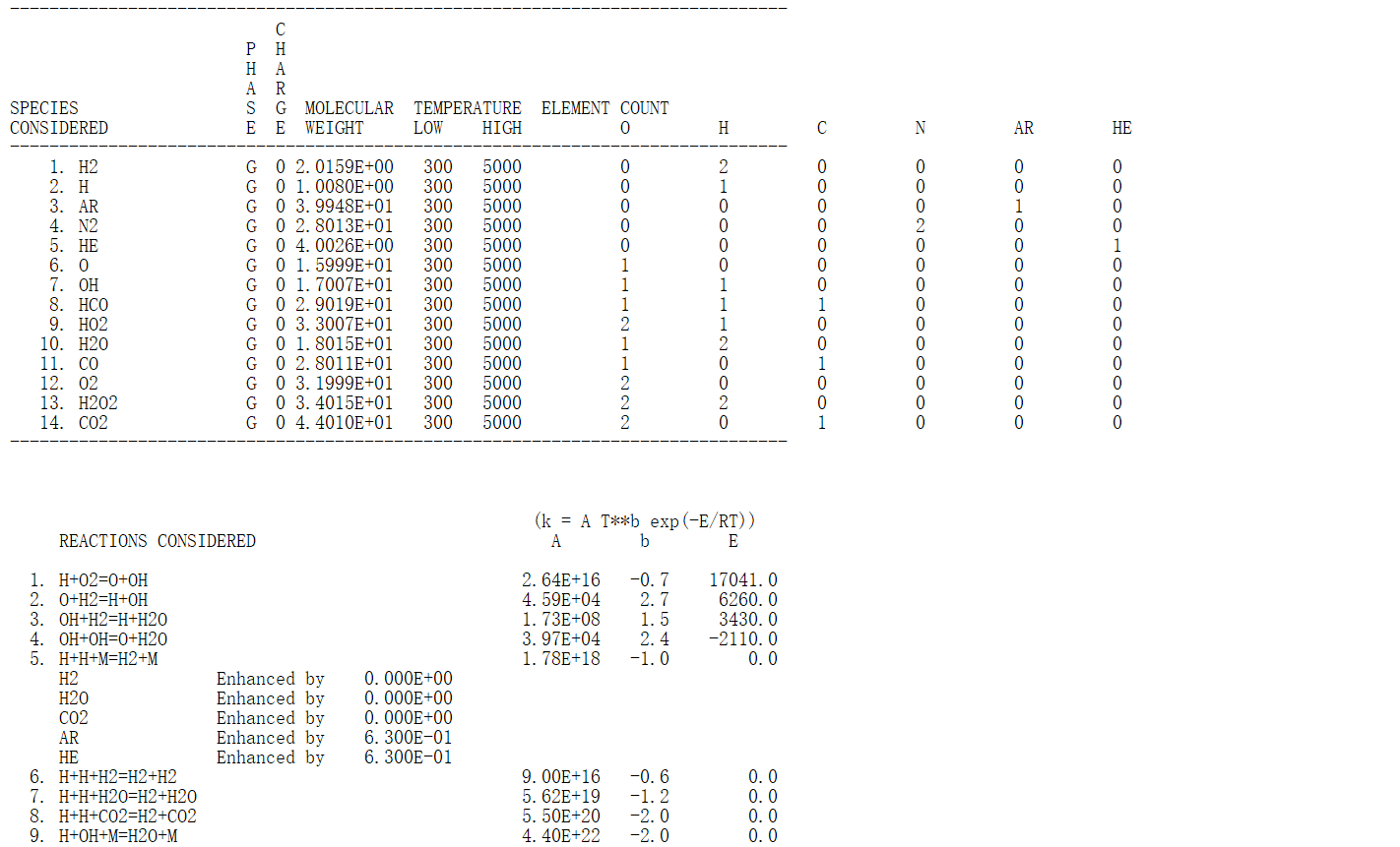

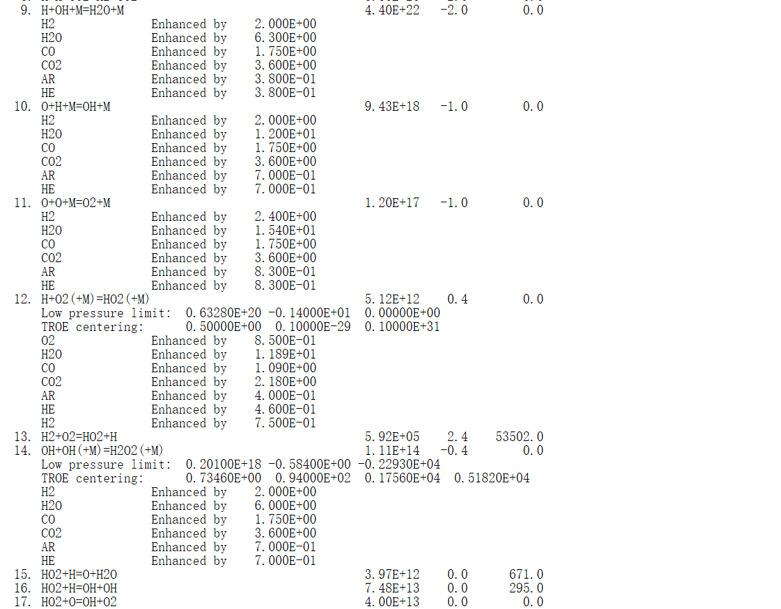

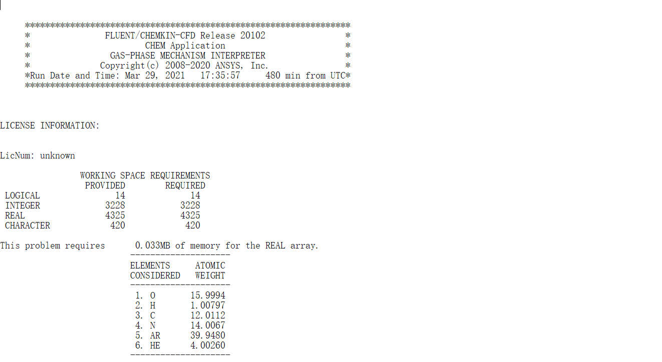

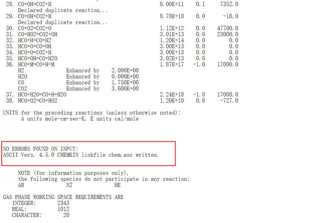

Ansys EmployeeCan you try reading another mechanism? There are some which are provided in the installation directory of fluent (fluentxx\Kinetics\data)nMarch 31, 2021 at 12:11 pmEason_23
SubscriberI have tried, this is the chem.out file. The reaction mechanism is correct, but Fluent still shuts down automatically after import.n
