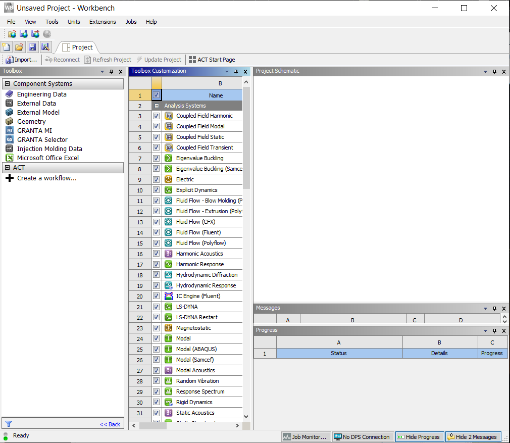

I had my Academic license, then I received the key for the ansys manager I upload it and work but then I update my ansys fluid and structures because I need the module ICEPACK and when I tryed to open the workbench it just don't worked now I tryied and it always says it looks like the server is busy try again later, and the error appears every time I try, also If I try to add let's say any tool to the toolbox when I check the module in View all/options of the toolbox it does not work and it just appear :

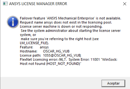

May 13, 2021 at 9:14 pmMay 14, 2021 at 11:54 amANSYS_MMadore
Forum ModeratorIf your license is installed on the same machine, you should be specifying OSCARLAPTOP as the hostname based on the details you have provided. Is OSCAR_HG_VUB some other machine, as that host is not known to the client you're on, OSCARLAPTOP.
