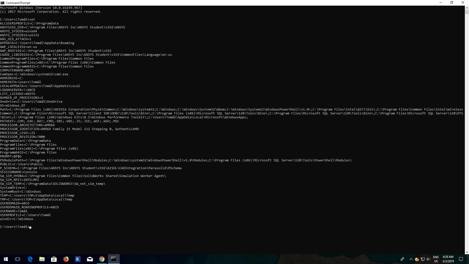

    • tsiriaks
      Tomas,
      Have you tried opening Workbench with the test user account (with the pure English letters) ?
      If that doesn't help, from that same test user account, open CMD Prompt, then issue the following command
      set
      then post the output of it here.
      Thanks,
      Win
    • Tom611
      Yes,I have. I created en account and tried to start it. It didnt work.
      Here is my output from CM:
      https://drive.google.com/open?id=1WfqbO85UCUm8sBA8O0ORXFZIxxmhM0vJ
      Thank you,
      Tom
    • tsiriaks
      Hi Tom,
      Is this from your test account ? Because your username isn't in English.
      Thanks,
      Win
