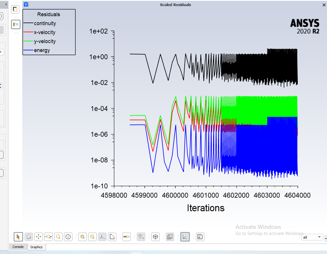

      Are the residuals (specifically the energy) converging at every timestep? You can also check energy imbalance in the system.
      Let me know.
    • abhnv11295
      There is energy imbalance inside the system.
      Evaporator = +Q1 watt
      Condensor = -Q2 watt
      lQ1l > lQ2l
      Net heat is positive. That means condenser is not releasing the amount of energy given at evaporator section.
      For residuals below is the attached screenshot, it looks like it is converging. Kindly put your opions on this.

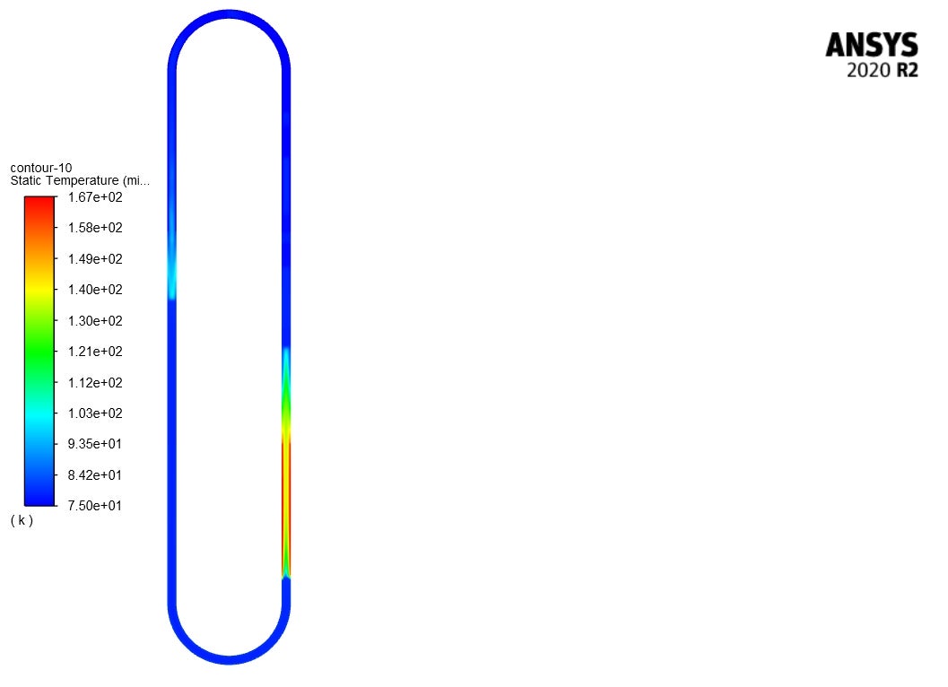

      Can you share the temperature contours?
    • abhnv11295
      Here is the temperature contour for a songle loop PHP.
    • Nikhil N

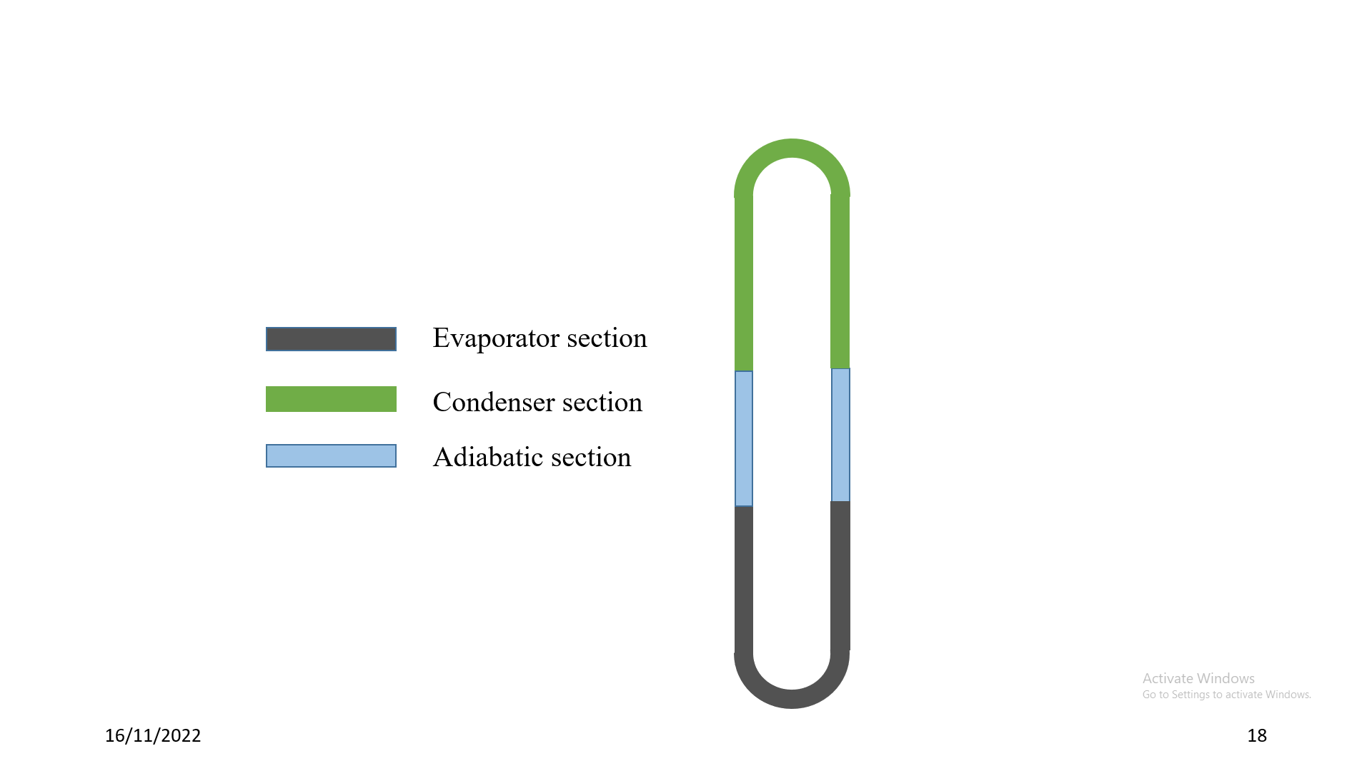

      Assuming that the bottom-most section is the evaporator section, why don't I see a rise in temperature there; rather, the temperature variation can be observed in the vertical adiabatic section. Please correct me if I am incorrectly pointing out the sections. If so, can you highlight the evaporator, adiabatic and condensor sections? Perhaps some illustration will be helpful.
    • abhnv11295
    • abhnv11295
      The increase in temeprature is very high as expected.
      The critical temperature for Nitrogen (working fluid for my simulation) is about 126K but the temperature rise in my system is very high. And that too for a small heat input.

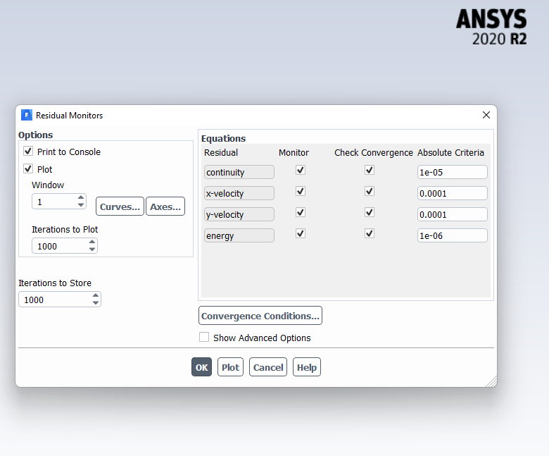

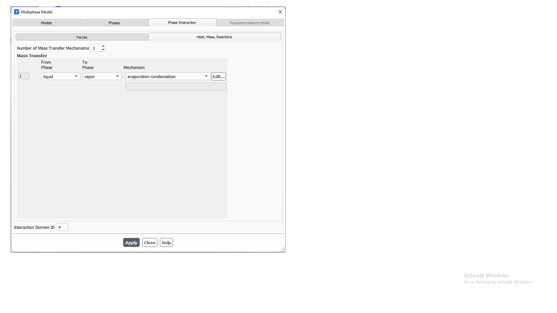

      By the way, why there is no vf-residual in the residuals plot? Also, have you set the mass transfer and saturation settings properly? Please check.
    • abhnv11295
      In VOF multiphase model, I did not see any VF- residual in RESIDUALS.
      In Mass transfer mechanism, Evaporation-Condensation model is chosen. Then Lee model for Phase interaction.
      Accomodation coefficents have been tried to fine tune with experimental results, Saturation temperature is set as a polynomial function of pressure.

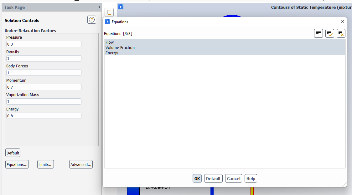

    • Nikhil N
      Then I suspect you must have frozen the VF equation. You can check that here: Solutions -> Controls -> Equations. Send me a screen grab.
    • abhnv11295
    • Nikhil N
      Was that already selected or did you do that now, before taking the screenshot?
    • abhnv11295
      All the three equations were selected before taking the screenshot.
      I have one doubt to ask, isn't the "Continuity" residual represented by the "Volume fraction" equation in VOF?
    • Nikhil N
      In VOF, for two phase flows, an additional transport equation is solved for the VF of the secondary phase. For primary phase, volume fraction is simply calculated by: VF = 1 - VF of secondary phase. For more details, please check this section of the theory guide: 14.3.4. Volume Fraction Equation (ansys.com)
      If you are not able to access the link, please refer to this forum discussion: Using Help with links (ansys.com)
      Thanks!
      Nikhil

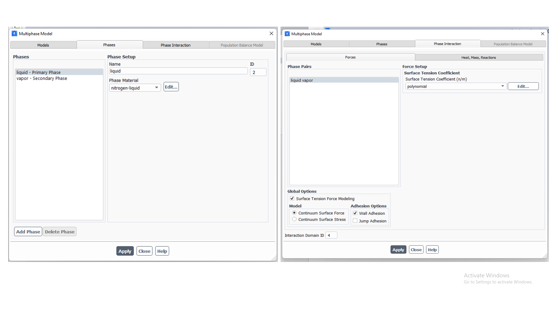

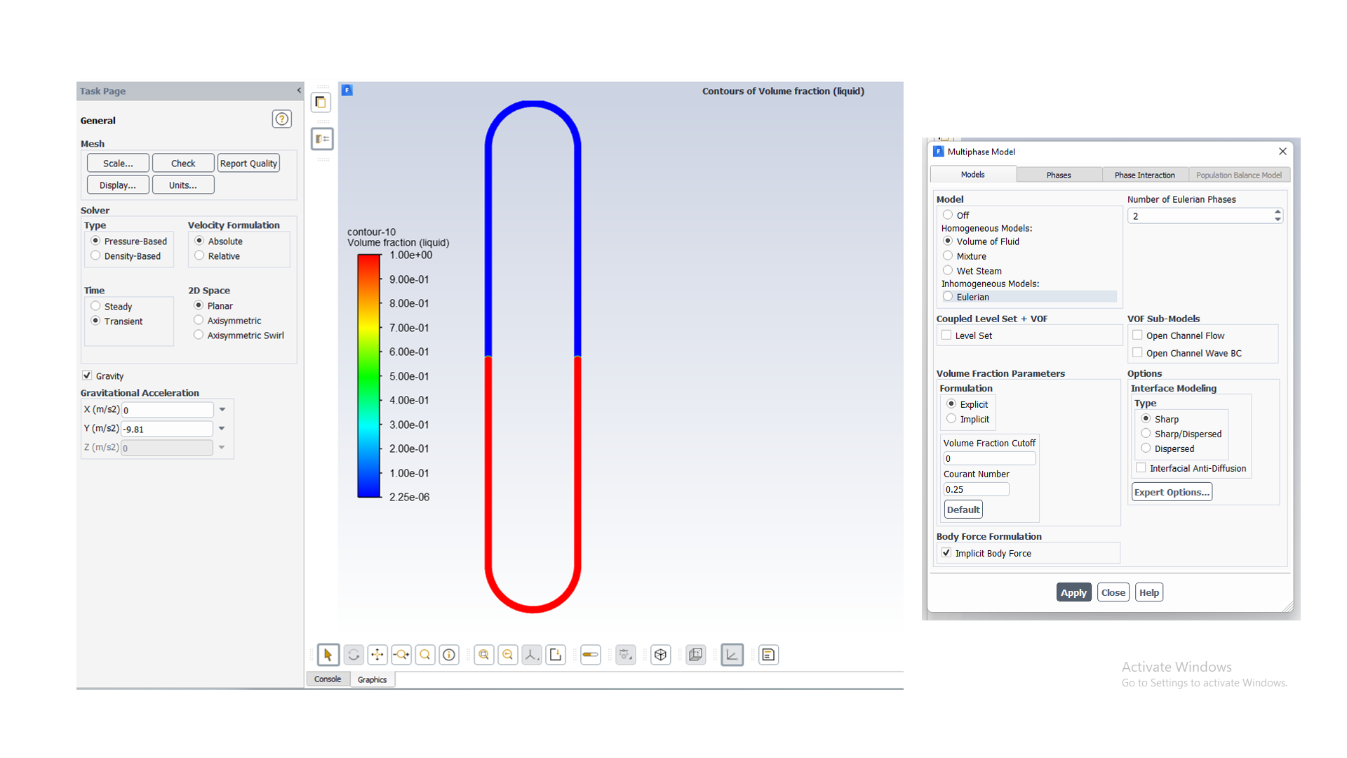

    • SRP
      1) Did you activate the term "implicit body force"? (It is activated as follows: multiphase model>Body force formulation>implicit body force.
      2) Did gravity point in the proper direction, or not? Just make sure
      3) Would you kindly send a screenshot of the volume fraction after patching, as well as a screenshot of the phases you specify and their interaction?
      Thank you
    • abhnv11295
    • abhnv11295
    • Nikhil N

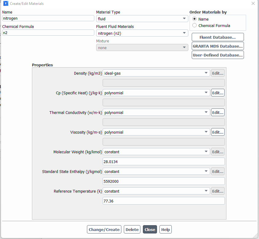

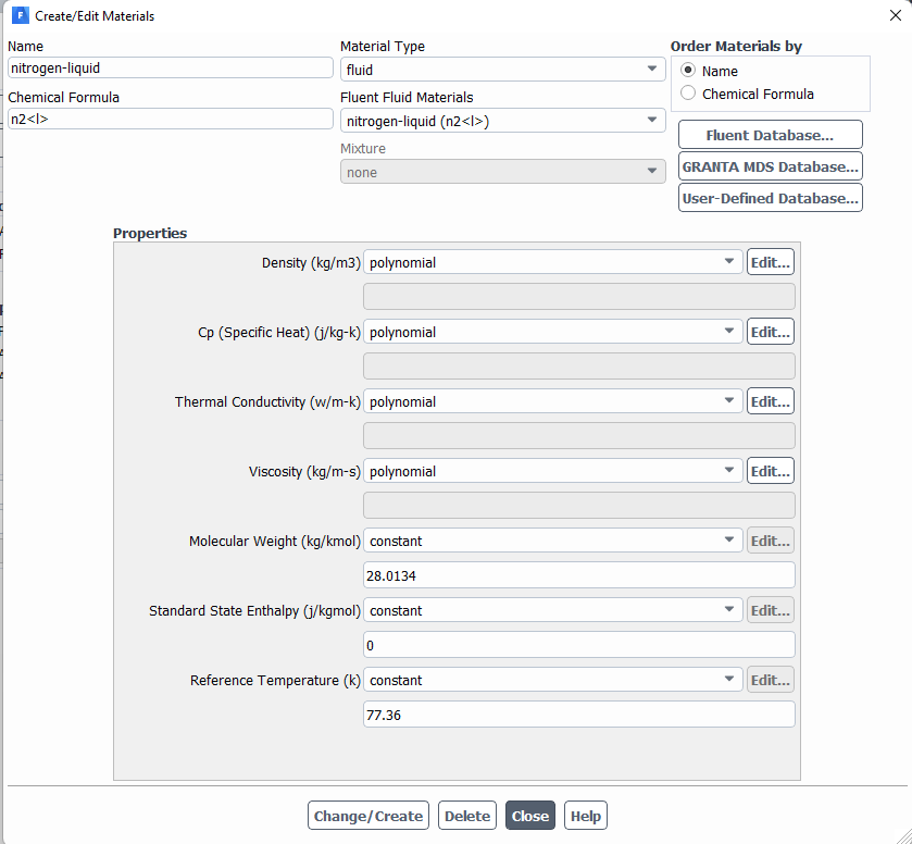

      Make sure you set the Standard State Enthalpy for the liquid and the vapor correctly. Can you share the screenshots of the material properties window for both, the liquid and the vapor?
    • abhnv11295
      Here are the mateiral properties window for liquid and vapor both
