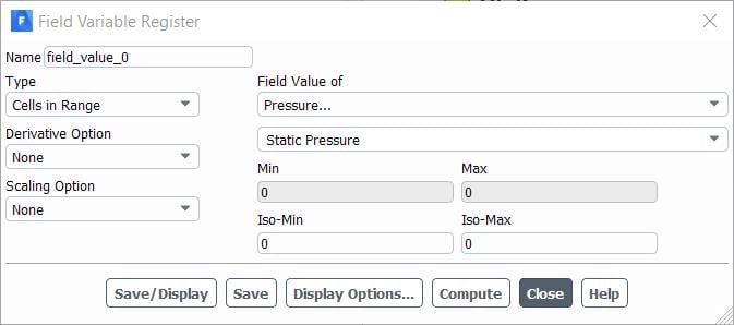

during the simulation (Fluent 19.5) I get the warning that temperature was limited to 1 K in a couple of cells. So I stopped the simulation and tried to find the area by using the Mark/Adapt Cells by Iso-value function (I switched to the 19.2 GUI for that function).
According to the dialog box, the temperature range is from 1 K to 700 K, but when I try to mark the cells from 0 K to 270 K (as the temperature should actually not be below 280 K) no cells are marked. The same with cells of temperature upwards from 300 K. So I wonder if the warning is wrong or how I can identify where those cells are.

SubscriberDear Karthik,
Thank you for your answer! Here is what I got:
In the console, 3 cells are limited to 1 K, and when I use the compute button in the Field Variable Register, it also shows me the range between 1 and almost 700 K. However, trying to mark the cells between 0 and 10 K for example results in 0 cells marked (see screenshot).
Don't know if I need to mention that I use a polyhedral mesh, almost 10,000,000 cells in parallel mode, also using shell-conduction. My inlet temperature is 281 K (outdoor air flow around buildings) including radiation. The temperature should be in the range of 280 K to maybe 300 K. When I try to mark the cells between 300 and 700 K also 0 cells are marked. So in fact when I enter 280 K to 300 K, all cells are marked, but I don't really get why I get the error then. I assume there are some bad cells (although inverse orthogonal quality is below 0.88) that cause the problem, so I just wanted to see where in order to adjust the mesh accordingly.

Ansys EmployeeMaybee the values reported corresponds to extrapolated face values or the virtual cells due to shell. Not sure though. Anyway having such a low value is nonphysical. Better to focus on having better mesh quality metrics. Increase mesh check verbosity to 2 and re-do a quality check. Very important are skenwss, orthogonal quality, aspect ration and cell volume change.

Johannes
SubscriberYes, I just wanted to see where the problem areas are so I can edit the mesh there. Skewness, orthogonal qualiy and aspect ratio is reported quite OK in my case that's why I wondered...

Ansys EmployeeIf they are as you say than check the boundary you are using.

SubscriberI just found out that the temperature warnings occur in (deleted) shadow zones of walls that were sewn together. That is probably the reason why the cells are not displayed.
