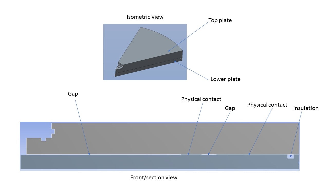

      Hi, i am trying to give a temperature to the attached geometry (parasolid  file) as function of radius and angle. The attached geometry is 1/8th of the full circular model.
      i am using static structural module as i am currently interested in 2D steady state conduction.
      Also, i need to know how to model or which connection to give between the contact surfaces of the upper and lower plates.  I  have updated the attachment as triangular geometry

      Hi, please find the image to better understand the geometry
      Shankar, that is a good description of the geometry and the contact/gap conditions along the interface.

      Is the Gap filled with air or another fluid?
      Is there any flow of fluid in that gap or is it stagnant?
      Do you have any data on the thermal resistance at the faces that are in Physical contact?  ANSYS assumes perfect thermal contact, but the thermal resistance can be included in the contact definition.

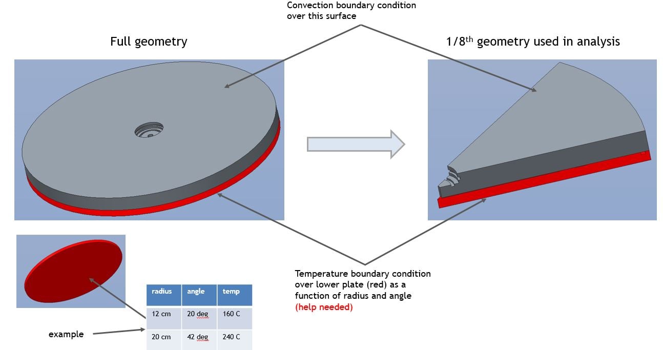

    • malay_shankar
      Hi Peter,
      Please refer to the images above for the boundary conditions.
      In the 3D slice geometry case the temperature is dependent on the angle, so we can not take it as axisymmetric model.
      Yes, there is a fluid flow from top but due to O-rings and gaskets installed the gaps will be insulated.
      I do not have any data on thermal resistance, so kindly suggest me the ways in which I can model the thermal contact. If that data is needed to model, i will try to get it.

    • malay_shankar
      For a thermal contact between the two put a thermal conductance value. Is this correct?
      I will try to get thermal resistance data and input it.
      Regarding temperature input  i am still struggling to find out a way to enter temperature as function of two variables. (radius and angle)

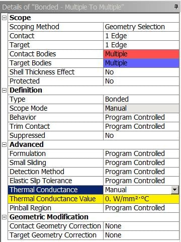

      Shankar,
      Create a Bonded Contact on the edges that touch in the 2D model (or on the faces that touch in the 3D model).
      When you do that you can override the Thermal Conductance setting and type in a value of Thermal Conductance at that interface. When you leave it Program Controlled, it assumes there is no additional thermal resistance at the contact interface. You can instrument a prototype and measure the contact resistance. I don't know if there is a good generic value.
      Any edges that don't have a Boundary Condition are assigned an Insulated BC in the solver, so you don't need to apply that manually.
      It's not credible that there is no heat transfer across that thin gap, because it is so thin. If there is stagnant air in that gap, that can still conduct some heat. I recommend you add a body to fill that gap and assign the thermal conductivity of air to that thin rectangle.

      I have solved the 2D geometry and got the desired results. But, i need to solve the same with 3D slice geometry, and input temperature as a function of radius and angle.
      Kindly help me on what is a temperature map and how it can be provided onto the model?

      Malay,
      Can you attach a zip file with an example of the distribution of temperature as a function of radius and angle?
      If you specify a Temperature Boundary Condition on the top surface, then you can't specify a Convective Boundary Condition on that surface also. You have to choose one or the other.

    • malay_shankar
      Peter,
      I do not have any zip file for that. Please refer to the image. I hope this will make you understand better.
      The "External Data" module is a convenient way to import external data and map it into the workbench module.
      Check the following video for the format that is required:
      Mapping by External Data system
