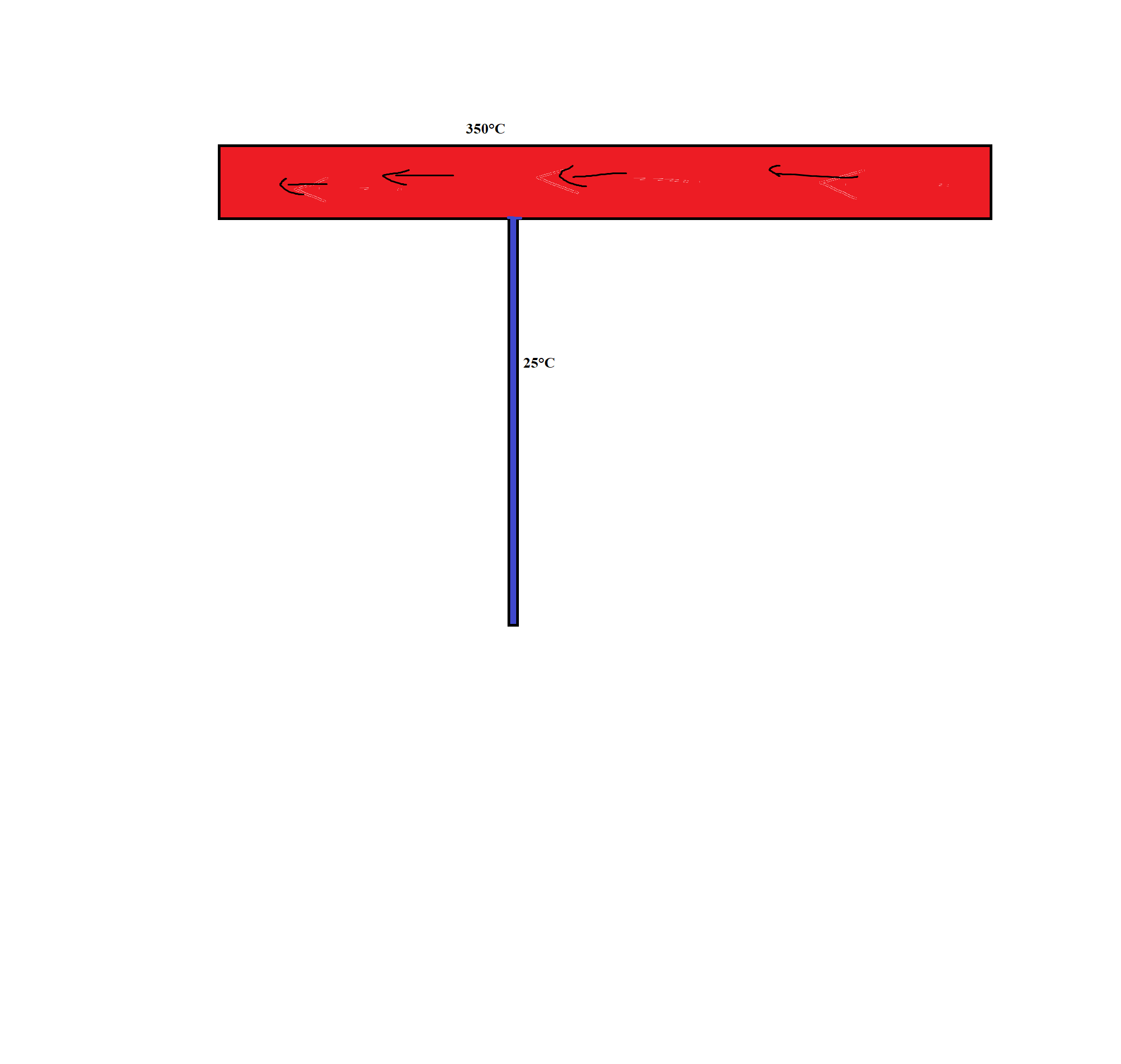

      First things first: I have a pipe thats has an oil flow with 25°C. On the bottom of this Pipe there is a capillary, with a sensor at the end. Now, when everything is filled, i want to heat the oil in the pipe to 350°C. I want to know how long the Capillary has to be so the Temperature on the Sensor is low enough (120°C) so the sensor wont get damaged.
      Thats why I wanted to simulate it. I watched some videos and to make it easy I wanted to make something like in the picture attached. I have 2 bodies, one for the Pipe with the 350°C and one for the capillary with 25°C. The walls and the Oil are modelled seperatley so I can have different materials. One for the Pipes and one for the Oil. Now I wanted to add conduction at the outside of the Pipe, simulating the ambient temperature nof 20°C. I wanted to simulatie it as Transient Thermal in the Mechanical program.
      Do you think I can do it like that? My professor told me its only to apporach the lenght of the capillary so we have an Idea how long it could be. It isnt the main part of the Thesis.
      Or do I need to use ANSYS Fluent?
      I hope you can help me, I would appreciate it!
      If you can ignore convection terms then Mechanical is fine. You may need to include the metal bits as bodies (I don't know much about Mech as does) for the conduction. I think there are fluid element to mimic the fluid-solid heat transfer too.
      We'd use CFD (Fluent or CFX, I'd go with Fluent) if the temperature profile in the main flow was very non-uniform or you needed to consider convection (buoyancy) in the capillary tube. In reality, is the tube material able to mix with the main flow?

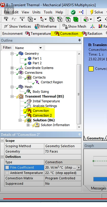

      Thank you for your answer. You say "If you can ignore convection terms then Mechanical is fine". But I watched some tutorials and there I can chose Convection in the Ansys Transient Thermal tool (Image). Or is this something else?
      The tube material could mix with the main flow because its the same fluid. But I think it doesnt happen because there is no flow in the capillary am i right? And im installing the capillary under the main pipe, so the warm fluid in the main pipe wont flow up.
