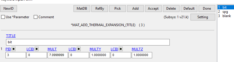

I did not find information on where you can set the coefficient of thermal expansion, for example for steel and sand:
Can I install them in this THERMAL_EXPANSION in the MULT column?
___
I use units: GPa, mm, ms, kg. Can I set the coefficient values as shown in the pictures above? If not, in what units should they be installed?

SubscriberThank you. You did not answer my question. Where should I set this coefficient? Did I correctly suggest in the MULT column?

Ansys EmployeePlease see the manual entry for MAT_ADD_THERMAL_EXPANSION, it describes how to specify the thermal expansion coefficients. You can also get a description of each parameter by clicking on the blue underlined parameter name in the Keyword Editor
