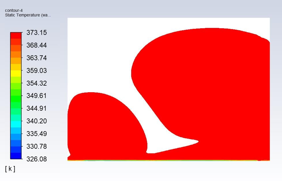

      I have the following contour plot. Although the "filled" option is selected, yet the post-processing in Fluent shows some missing area. The solution I'm expecting is how to ensure it fills all the domains.
      Even if I select the surfaces, it shows the contour plot on the mesh. It the second plot.
      I appreciate the help. Thank you.
      Best regards,
      Hamed.

      If this is a 2D simulation, could you please deselect all surfaces, make sure that the Global Range option is checked, and plot the contour? Could you also check 'Boundary Values' and try?
      Thanks.
      Karthik

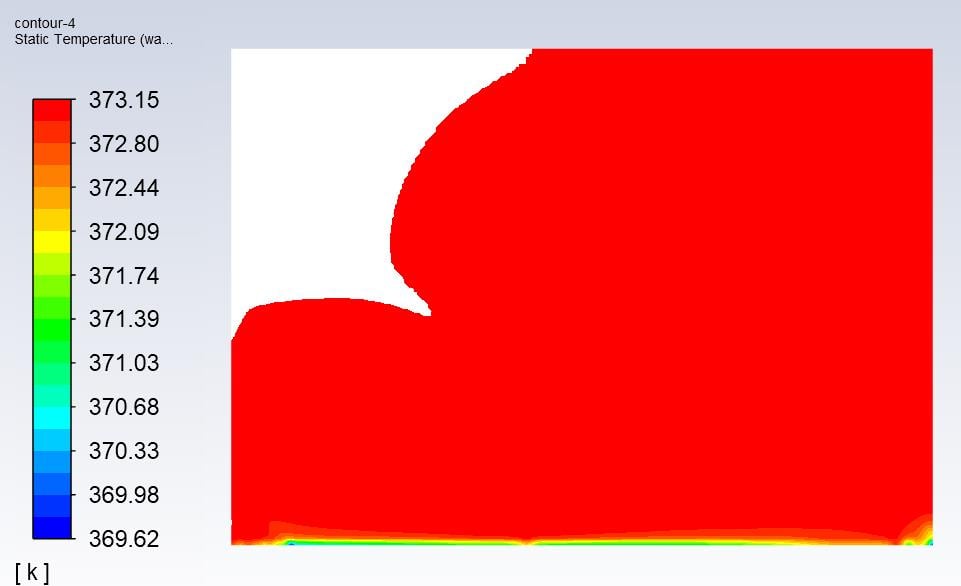

      Thank you for the response Karthik. These are contour plots is the same order:
      a. Deselected all surfaces and Global range turned ON
      b. Deselected all surfaces. Global range and Boundary range turned ON.
      Thank you for your help.
      Best regards
      Hamed

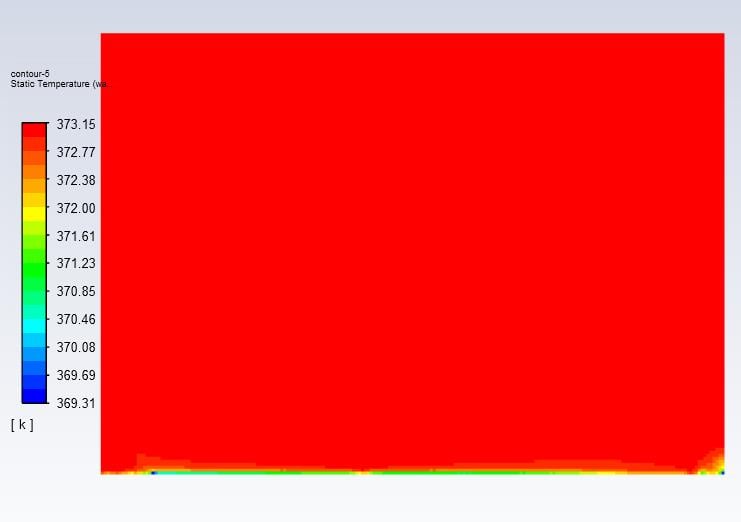

      I found that this occurs when I used "Banded" in the contour plot. However, when I change it to "smooth", I get the following. Can you please explain this?
      Thank you.
      Best regards
      Hamed.

      When you are using "Banded", can you uncheck "Node Values" under the Options menu and plot the contour.
    • ham_nola
      Thank you, Rahul. Selecting banded and turning off the node values resolved the issue.
      Could you please explain it as well? Thank you.
