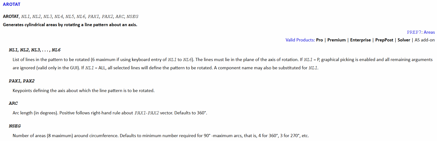

Ansys EmployeeI tested by making an area in APDL. I entered the command AROTAT,ALL,,,,,,60
I looked in the APDL shell, and it printed these lines for creating area and rotating:
CREATE A RECTANGULAR AREA WITH
X-DISTANCES FROM -0.4000000000 TO -0.5000000000E-01
Y-DISTANCES FROM -0.1000000000 TO 0.2500000000
OUTPUT AREA = 1PLOT AREAS FROM 1 TO 1 BY 1
ROTATE LINES 1, 2, 3, 4,
ABOUT THE AXIS DEFINED BY COORDS
0.78886E-30 0.78886E-30 0.78886E-30, 0.78886E-30 0.78886E-30 0.78886E-30,
DEGREE OF ARC= 360.00 NUMBER OF SEGMENTS= 4*** ERROR *** CP = 1.188 TIME= 00:24:10
Keypoint 60 not defined.So both the "ROTATE LINES" message and the error "Keypoint 60 not defined" are not coming from running any other file. The ROTATE LINES is typical for this command, and the keypoint 60 error is from the wrong format of the AROTAT command. Please refer to the help page on this command:
https://ansyshelp.ansys.com/account/secured?returnurl=/Views/Secured/corp/v251/en/ans_cmd/Hlp_C_AROTAT.html
The command says it "Generates cylindrical areas by rotating a line pattern about an axis" so the ROTATE LINES message seems justified. And your 60 value is in the place of the PAX1 argument, which is expected to be a keypoint. I think you meant tp specify 60 degrees for the ARC argument. But even if you do this, you will still get an error because the axis points are not defined. Therefore PAX1, PAX2 are required arguments.
