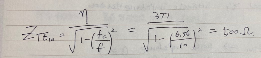

SubscriberI have simulated, in x-band, WR-90 standard waveguide.
The TE mode characteristic impedance ( at 10 GHz ) was obtained through the formula below.
June 28, 2021 at 12:10 amAndyJP
SubscriberSorry, I made the same mistake as yours : forgot changing the port impedance to Z-wave.
The default Zpi definition does not work well for RG, because of shunt wall and transverse currents in it. It is better suited for parallel plate and microstrip lines with large port cross-section.
