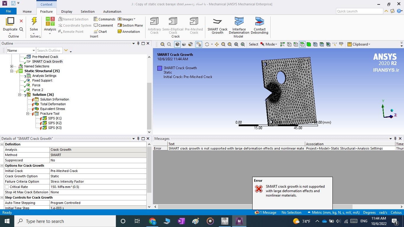

      Hi every one
      I want to model static crack growth under elastic-plastic fracture mechanics, I choose bilinear for first  step ( fracture-pre meshed crack-smart crack ( static)) and gave me an error can you guide me
